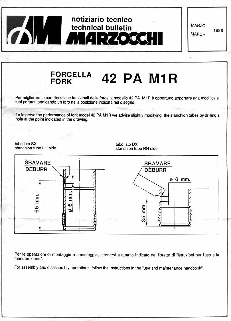

I just bought some replacement fork tubes from a reliable supplier in Germany , they are the correct part numbers , correct lengths & diameter , but at the bottom of each tube there is no step for the bush or hole drilled for the passage of oil .
My question is has any one else seen or fitted tubes like this or are they just wrong .
Are they for an earlier model M1R ? . I have seen a copy of a factory document that suggests drilling the oil passage holes .
Any thoughts ?

There was a tech bulletin from Marzocchi which was also on the forum for a while but which I removed as it is for a M1R but for the "42 PA M1R" which is an offroad version used i.e. on a 1986 KTM.I have seen a copy of a factory document that suggests drilling the oil passage holes
While that mod may work well on our M1R, too it might not really be necessary as it doesn`t travel that much.
- (67 KiB) Not downloaded yet
- 20118EGt.jpg (33.11 KiB) Viewed 12757 times
