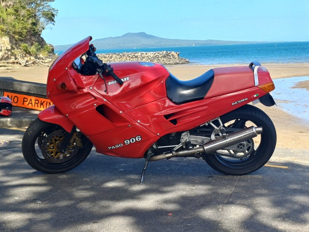

3300 km since transplant and running great, due it's first oil change.
All the details are on ducati.ms under thread "Zen and the art of motorcycle mutiliation".
