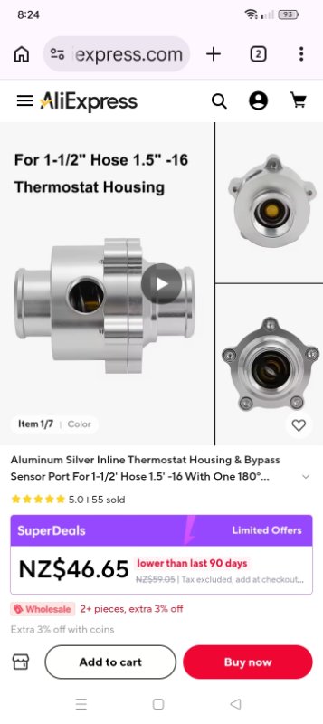

Hi Nick , yep , been on my mind for ages now . I figured that when I had to Id get something adapted to work ....bunch of new hose bends and ....dunno what they are called but hoses and bends with different diameters at each end and a few joins .
A quick look found this .....mmmmmm nice and shiney ,look real fast and bound to double hosspower😁

That does look pretty! I was beginning to wonder where you were!
I have found all the parts, such as the thermostat, cover and gaskets. Now to measure it all up once it’s all in the same spot. Hopefully next month? There is an online silicone hose outlet that does all sorts of bends, adaptors and straight hose in Victoria, so it’s all coming together.
The one thing I can’t get my head around is the direction of flow of the coolant. Who ever designed the original must have been a failed plumber! At least the S4R flow seems to be relatively simple, is it in reality? The impellers all look the same, but do they operate differently?
That thermostat you put in your post looks the ducks nuts though!
