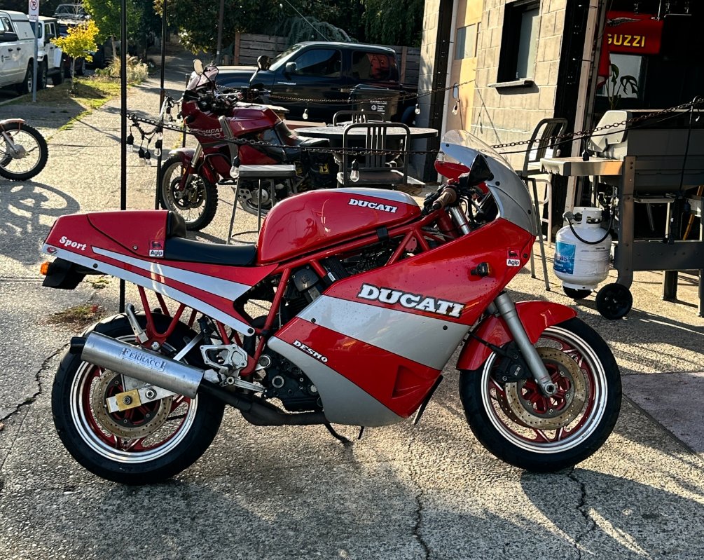

Saw an ad for a 1990 750 Sport near me for... not much money. So I sent a flurry of messages throughout the day and made him stay up past bedtime to meet me.
Owner had purchased the bike in 2000 - already outfitted with 36mm pumper Dellorto setup, some familiar wiring mods and Ferracci mufflers (!) - and other than some dust and road grime, it was very clean. He said that it had a bent valve - but somehow ran - and that it just bogged under acceleration. I'm no rocket scientist, but I didn't think all of those things could be true at the same time. We tinkered on it past 10pm in his garage, seems the 2nd cylinder cam was off a tooth - but he admitted he had 'played with the timing belts' before he listed it. Thankfully we didn't use the starter to test immediately! I got it timed correctly, and was eventually able to turn it all the way through with the rear wheel. I borrowed a battery to try the starter and both cylinders had compression. Anything else I was sure I could figure out, so gave him cash and brought it home.
I host a bike/shop night at my coffee bar in Seattle - we work on bikes and help anyone that needs guidance navigating simple issues. Between serving beers I'll hop into the fray to futz with whichever project is queued up. I INTENDED to go through the top end before attempting a startup, to make sure everything is where it should be, but after a chat with a veteran moto tech, his advice was if there's no interference and compression, just send it. So, I dribbled some fuel down the hose of this beautiful thing and hooked up a battery. A couple cranks and it roared up and calmly settled to an idle. Sounds amazing and I was the coolest guy in the Pacific Northwest for about 5 minutes.
Shortly after this amazing moment, someone bumped a galvanized pipe that was leaning on the wall and it fell right square on the rear seat cowl, cracking it on a very unfortunate corner. I had to walk away and find a quiet place for a few minutes, but otherwise it's been an exciting, if bittersweet 18 hours of ownership.
When everyone left I put in a late night with the bike on the lift. I tested compression - ~115psi in each, though I don't have full confidence in this gauge. Scope just showed heavy carbon on the piston, and maybe a little nick from a valve kiss, but otherwise a very clean combustion chamber with a nice hone on the walls. No real evidence of a catastrophe. Accelerators on the Dellortos spray cleanly and slide action is smooth. A manual came with the bike and there's a sheet stuffed in the back with a running log of maintenance covering the last 25k of its 33k mile life - also detailing accounts of a camping trip he took with his dad where it fell off the sidestand in some dirt, and a lowside incident from some sneaky gravel - which explains the spare fairing that came with it.
I have no idea why the PO thought it had a bent valve, he couldn't give me a real answer about how he came to that diagnosis - overheated, I played with belts, it ran fine, etc. Nice guy, but I suspect his bogging was something else that I may eventually discover and he was just ready to move on. I will check valves and all the systems before doing any more vroom vroom, and there are some maintenance parts on the way - belts, sprockets, chain, battery, oil filter, etc. I will eventually drop the engine and inspect the top end, as it's a nagging thought, but I'm otherwise very happy to report another running, weird Italian in the stable.

Paso shouldnt be awkward shifting ....probly need to have a look at the clutch , they gotta be clean , any black marks on the drive plates will make it sticky , but a well sorted gearbox/clutch should be the proverbial hot knife thru butter . Even the chain condition/tension will affect it .

Mc tool wrote: ↑Sat Sep 26, 2026 8:53 am Paso shouldnt be awkward shifting ....probly need to have a look at the clutch , they gotta be clean , any black marks on the drive plates will make it sticky , but a well sorted gearbox/clutch should be the proverbial hot knife thru butter . Even the chain condition/tension will affect it .
Referring to the placement of the shift lever to the sidestand - I'd constantly have to toe the stand down a smidge to get under the lever.
