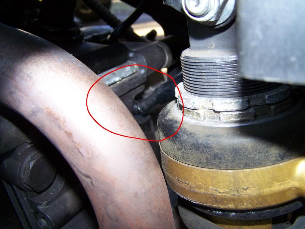

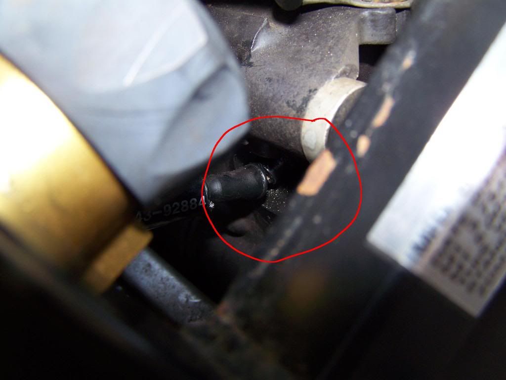

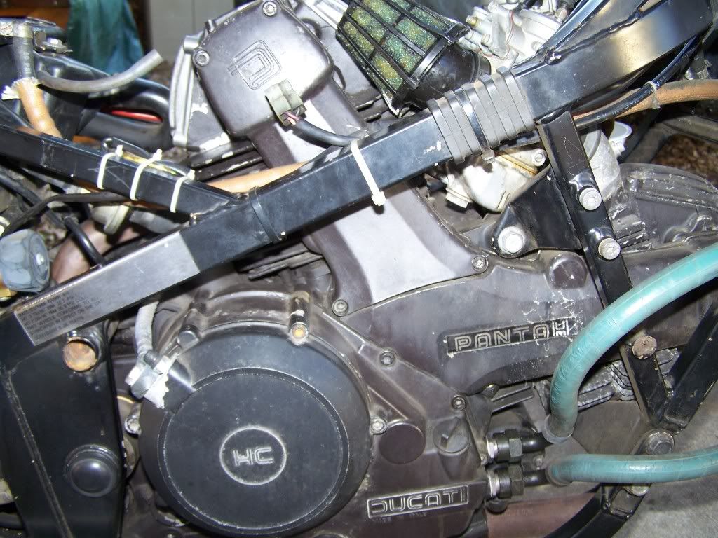

This plug is coming out of the back of the engine. The plastic cover has snapped and the wires are exposed. I have tried to slip a rubber hose over it but it was too thin
heres the wires from another angle

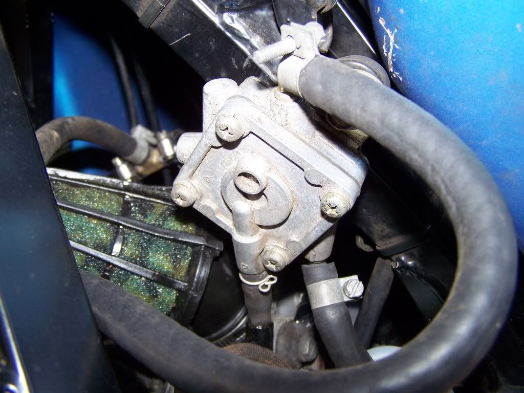

This is mounted where the fuel pump would have been. It splits the fuel line into a small line that runs into the engine (whats this for?) and then another line that splits and goes to each carb.

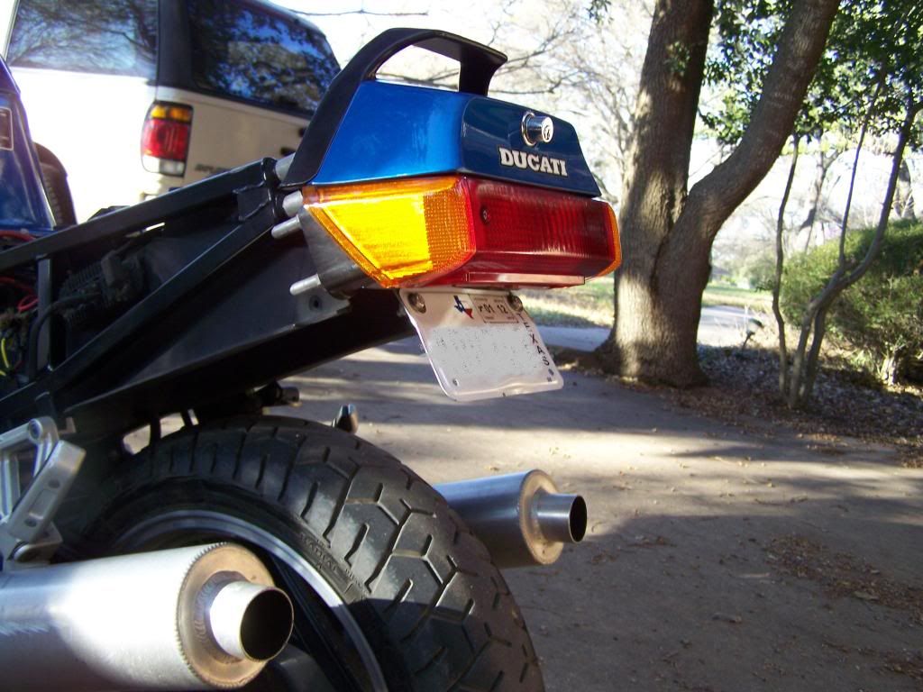

tail end mod.

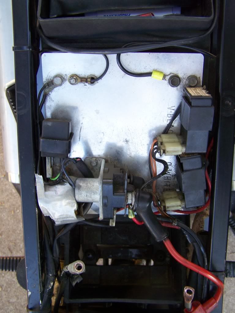

No rectifier here

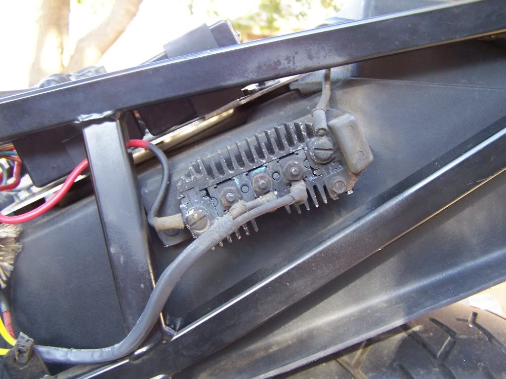

after market rectifier here

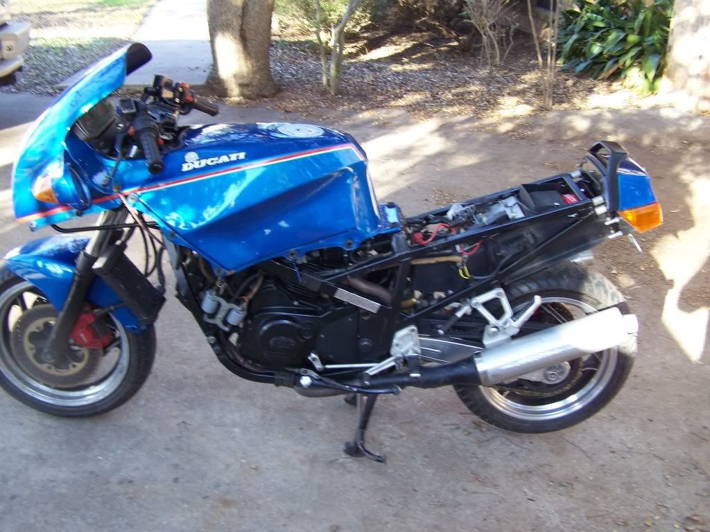

Here it is with all the fairings off. I will put up some more pics when I figure out the clutch
That is a vacuum type pump,should not be an issue as longs as it is working
could be the ground wire,best moved to the engine should be an empty bolt hole there already
No rectifier here
looks to me like you have a plehteraa of ground issues and electrical issues
shouldn't be there anyway but where is your ecm ?

Yes Ive noticed the imaginative wiring but I'm not having any electrical issues at all; will get the clutch out tomorrow and hopefully I can figure out what the problem is...
That`s the neutral switch.
I wonder how good those electrical connections are as the connectors seem to have paint on them.
Good eye G, guess I need new glasses :lol: :lol: :lol: :lol: :lol:
