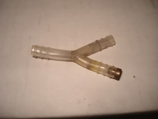

Do you see fuel returning into the tank when you turn on the key and look into the open gas cap? In my system, the most pressure that the carbs sees is basically the 12 inches or so of head between the float needles and the return line in the tank. The amount of fuel passing through the overflow is considerable. You can reduce the amount of pressure the carbs see a bit by how you arrange the T in your line. Make the straight through flow from the pump to the overflow(the top of the T), and the bottom of the T goes to a second T to split to feed the carbs.

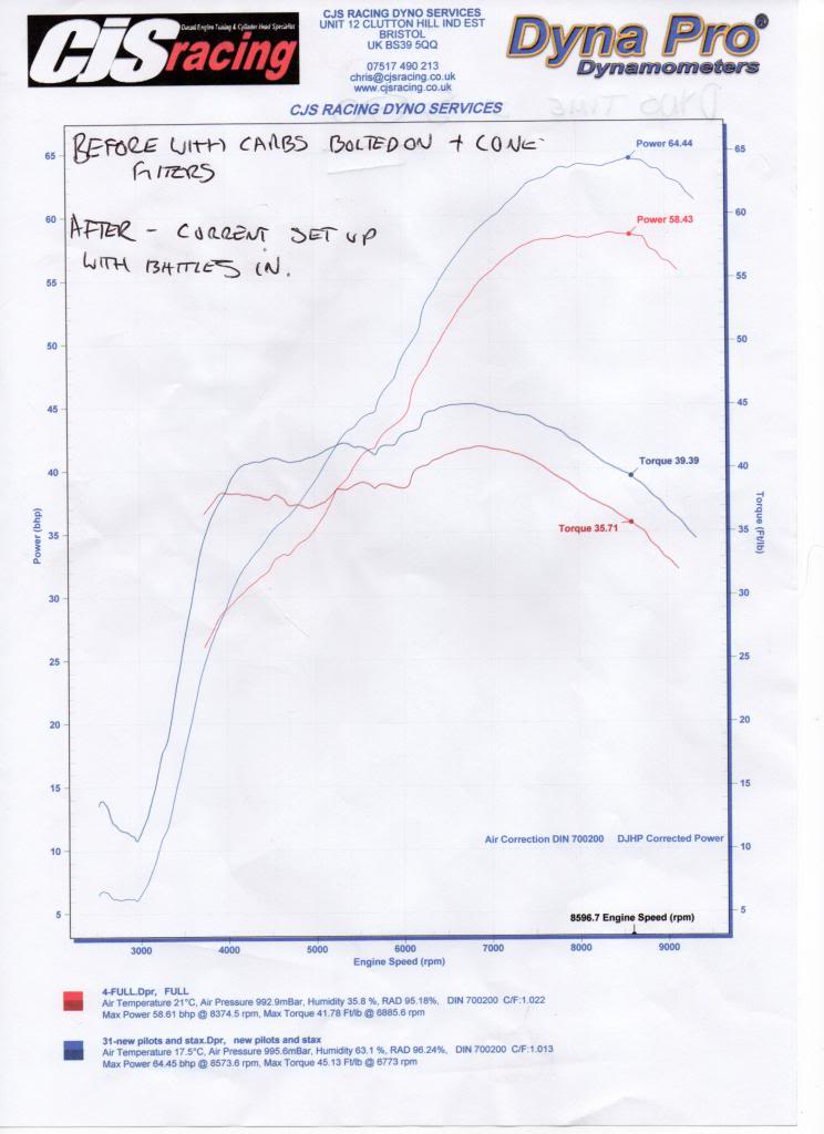

Had the bike tuned by Rich Llewellin, a local guru who specialises in Ducatis and has won awards for his race-bike preparation. Needed to swap out the needles to get rid of a weak spot in the midrange, and it turned out that the small K&N type cone filters were strangling the bike's breathing throughout the rev range (red lines on chart). The bike now wears small 45mm trumpets and is giving nearly 65bhp at 8500 with a near linear power delivery. Torque peaks at 45ft/lbs, but runs pretty flat from 4000.
When new, these bikes made 62bhp fitted with the Weber, so I'm very impressed that my 23 year old bike is giving more power with such a smooth delivery. Fitting the Dell'Ortos wasn't cheap, and getting them running right involved extra expense, but I reckon I've got my bike running as well as it ever will.

Daniel, that`s a nice curve. :thumbup: I figured the filters were very small, but are you now riding with no filters at all ?

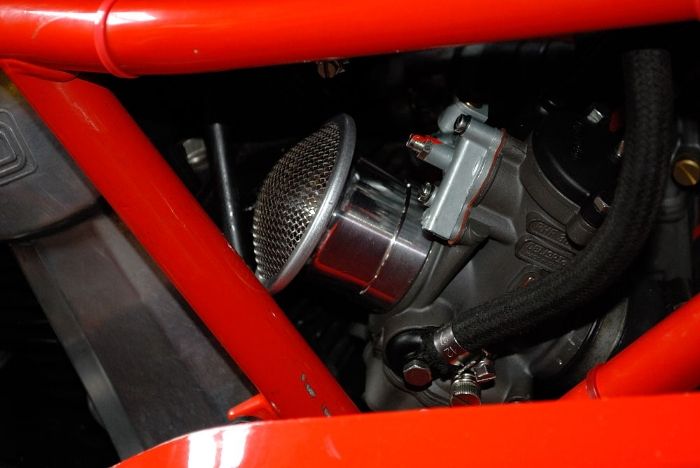

Thanks G - at the moment I'm just running with small intake trumpets with gauze screens.
I would have preferred filters, but I've run my Guzzi without filters for years and the the bores were unmarked when I stripped it at 60,000 miles so I'm not too worried about increased wear - the weather here's so damp I doubt I'll get any dust or sand in the engine. I suspect I'm not going to get the midrange that Phil and Maico get with their long intake tracts, but I'm really pleased with the way the bike's running.
I do get a lot more intake noise with the trumpets though - not bad at all!
