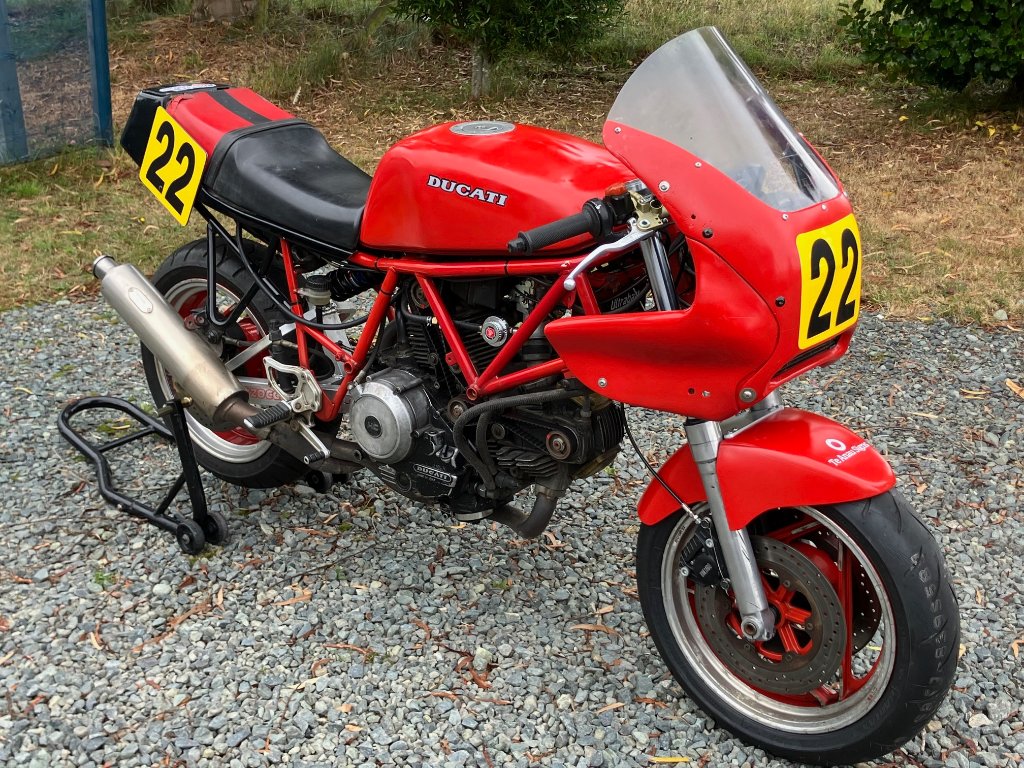

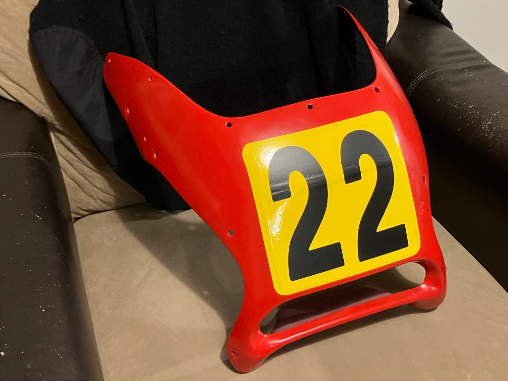

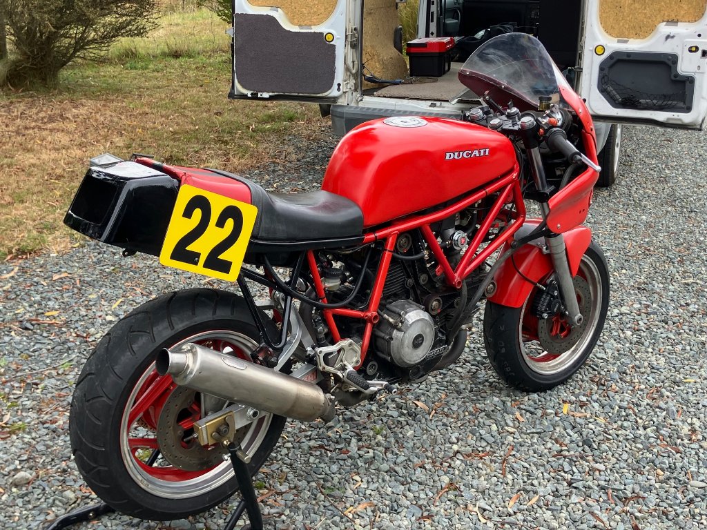

I filled in the hole where the headlight had been with some aluminum/plastic composite sign board material that bends and holds shape quite nicely. Just siliconed it in and after paint put some yellow wrap on the front number board area then applied the black numbers. I've been #22 since I started racing in 2015.
The finished product for now!
I'm happy enough, looks a lot better than when I first got it and it's ready to race. :thumbup:
