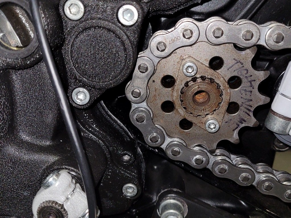

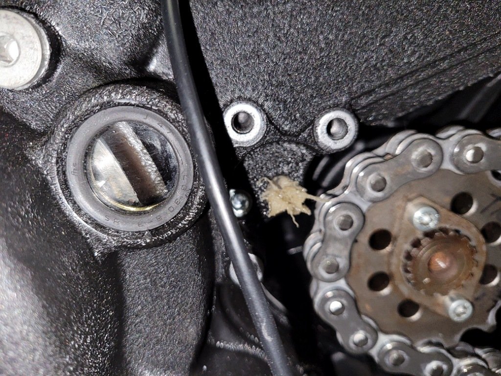

It's back on the lift to try and find what the clunking noise is that's coming from the front end.
Off with the fairing again.
That's when I noticed this on the lift.
So where's that coming from.
Not here.
I still don't like the way that's attached. Do you think there should be a locking tab that can be bent over the nut on there?.
It's looking like it's either the gear change shaft.
Or this cover.
I'll give her a wash while the fairing's off and keep an eye on it.

Hi mate, I'm not sure if the 750 is the same as mine but a oil leak around that area could be from the clutch push rod thing , have a butchers at this pic, mine is from a previous post, the bit of of rag bashed in there is just so I can start up to show off to a mate at this stage, but an easy fix, bikes looking fantastic and it sounds like everything is working out pretty good.

Cheers. It seems to be a different set up to yours but I'll have a look.
