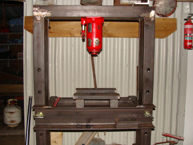

Thanks Bluey , specially about the driers . I thought that the media , after spraying fell to the bottom of the cabinet and just got sucked up again. I have used one before but twernt mine so I didn't care , just wanted clean crankcases :) . I guess I can live with that as it ( after the initial flurry of enthusiasm ) wont see a whole lot of use .... bit like the welders and drill press and the other press ( I made )
and a lot of other shit that is real handy when you need it :)
