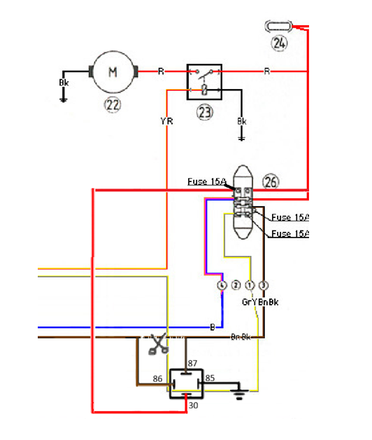

I was about to do the wiring mod that involves adding a relay to isolate the ignition switch from the main power. This:
https://app.box.com/s/64zvqpl6sf303gt44wu6
The images and comments below illustrate my confusion. There are various versions of this mod description scattered around the forums. Most are unclear about how to wire this relay. I found one write up regarding the Paso 750 that I thought spelled it out:
http://www.desmodemon.com/paso_project_5.html
Maybe this is obvious, but, as usual, it wasn't to me, and the description linked in the 907ie FAQ could mislead someone who is electrically challenged, like me.
Carry on.

Great stuff, Nick. Can you confirm the wiring of the relay is as shown in the last image and not the one in the actual 907ie file?
Re: 907ie wiring modification confusion
Posted: Sat Nov 09, 2019 5:41 am
by nickta
BillB01 wrote:Great stuff, Nick. Can you confirm the wiring of the relay is as shown in the last image and not the one in the actual 907ie file?
Hi Bill.
If it was me, I would connect the 12v to Pin 30 and have the switched 12v on Pin 87.
It will work the way it is, but convention (if you can call it that) is to have 12v on the fixed of a switch. No idea why?
The middle picture is probably the way I would wire it up, with a 4 pin relay. The bottom pic has a 5 pin relay, which has one pin not connected? The top picture is missing pin numbers, but starting at the top and going clockwise, they would be: 87, 85, 30, 86.
One further thing. Always have a fuse in line with the 12v to pin 30 of the relay (assuming you connect it to pin 30). If there is a fault with the relay in the future, and you short 12v to ground, you will blow the fuse. No fuse and you may end up melting a lot of insulation and sparks and what not. Worst case is fire under the fuel tank, which could really ruin your day. It is possible to use the existing fuse holder under the seat, if you want to make it look pretty, but an inline fuse holder is cheap insurance. You just have to remember where you put it! :banghead:
Hope this helps.
Cheers.
Nick.

Oh, so it will work either way. My electrically challenged mind finally sees that. In retrospect, it seems obvious. Sorry to be polluting the forum with my confusion. You spelled things out so even I could understand it. Thanks.

Yes, now I see it is a bit odd that the Paso 750 document shows 30 swapped with 87, but I get that it makes no practical difference.
And Nick, thanks for the idea of using one of the unused spots on the exiting fuse box.
And one other questions... What would be "the proper sized wire" for the power wire in this case?

I'm finally getting around to doing this mod, 6 years later, after my 907 mysteriously lost all electrical power twice, for a brief period. I observed the battery was overcharging (15.5 V), and replaced the voltage regulator and the yellow wires and connectors that were badly burned, along with the now-bad battery. Testing the bike, all charging was good, but it lost all electrical power again. Wiggling the cover on the bottom of the ignition switch restored power. Further wiggling caused it to come and go. So, I need to disassemble and check the switch contacts and DO THE WIRING MOD.
Based on Nick's comment (quoted above) about using the fuse block, which has an unused 15-amp fuse with bare connectors ready to accept some wires, I altered the existing wiring mod image to reflect this idea. Note that the only difference from the stock wiring, other than cutting the brown/black wire to insert the relay, is the red wire routed from the relay to the fuse block and from there to the battery.
This shows in concept what Nick mentioned. I will cut the brown/black ignition switch wire close to the fuse block to install the relay.
Thanks to Nick for this simple method. The original wiring mod diagram did not lead me to this simple way of doing the mod.
