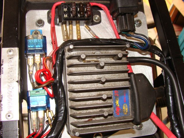

Also look up how to fit a main relay and save yourself further hassles

I have a question which may refer to the topic... when I switch on the ignition key, all the lights in dashboard are blinking in a rate of fuel pump. Is this maybe related to poor connection at ignition key or it is normal? May be just some bad ground connection (I'm inspecting this) or just Italian electrics :wink:
I did the wire upgrade with the relay for the ignition coils some time ago, but the issue remains.

sounds like a grounding issue to me , but it could also be caused by a poor connection in the power supply leading to low voltage . Paso;s are rotten with them . The easiest way is to learn about testing for low voltage or voltage drop ( over a connection ).
I fitted 1 relay for each .... ignition coils and magic box , power supply ( shown in pic ) and one each for hi and low beam ( up by headlight assy )

Mc tool wrote: Wed Jun 29, 2022 5:53 am sounds like a grounding issue to me , but it could also be caused by a poor connection in the power supply leading to low voltage . Paso;s are rotten with them . The easiest way is to learn about testing for low voltage or voltage drop ( over a connection ).
Thanks Mc tool! I'll go in the same direction :cool:
