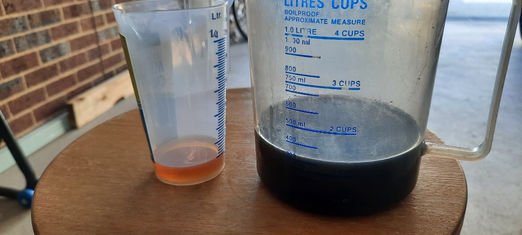

- Drained some excess engine oil out and discovered it's contaminated with petrol (quite a lot). I didn't over fill it upon a recent oil change after all, petrol contamination is the issue.
- Upon going through the carb, I noticed a lot of wetness between the fibre gaskets and I suspect they're leaking down the manifold. Carb was re jetted and these gaskets were changed about 8 years ago so they may be due for a change. Could be something else but thats my first impression.
To do or thoughts?
- Firstly I'm considering a compression test to ensure that side of things is okay.
- If compression is okay, perhaps a full carburretor rebuild? Or new gaskets at a minimum.
Oil pics attached (new vs used). Watery consistency and smells like petrol, has darkened and I've only done about 50kms since the oil change.

Flooding of that degree is as you stated either the top gasket leaking or the float not closing. There is also the possibility of a crack in the carb.
