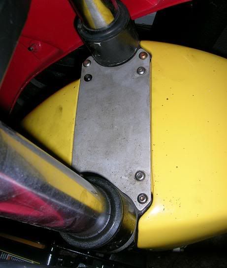

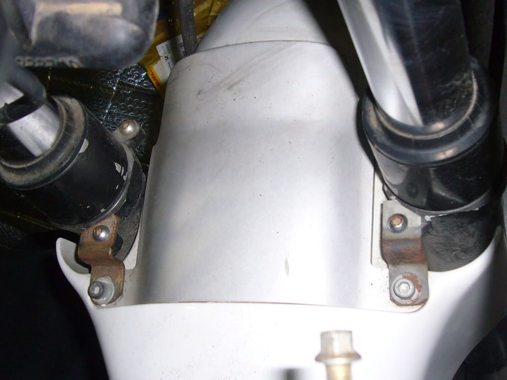

I cant believe I got this picture link to post (computers are not my strong point)
this is a picture of my funky fender mounting, any input as to whats wrong or missing would be appreciated. P.S. is this bracket supposed to be black or the color of the bike
Thanks John

Those Z-brackets and the fender bracket appear to be custom items, and the fender doesn't look like a stock one. This is what the original fender and fender bracket should look like...

I guess the search is on for more parts, thanks for the help

For those interested the fender on my 88 turned out to be a kawasaki unit off of a late 80s 600 ninja, it actually was a kinda close match and in a pinch and a little more skill making the attach brackets would make a pretty passable substitute, personally I could'nt have faced any fellow duc owners with a kawasaki fender on my bike
