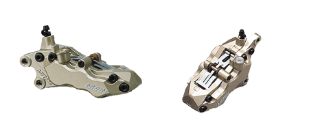

one day I may, but not as a necessity as I don`t think there`s any other reason than looks to do that job.
I already have 3 hanging systems an original from an 900SL, one aftermarket and another aftermarket from ISR which came from a 888 (the caliper and bracket are made out of one part). The issue is I don`t find a rear caliper that matches design and colour of my 6 piston Nissin front calipers

You can try painting the rear caliper. I seen something, it isn't impossible to do a good worg.

no. The one from the MV are (I think) the same, but the mounting hole distance on the MV is different, not 40mm.MV F4?
