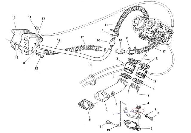

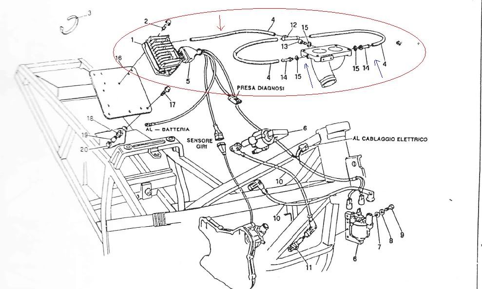

It is better with pictures I think.
What to do with the line from the digiplex (red arrow on Paso parts diagram) when installing Mikuni carbs?
I think it is OK to plug the hoses on the paso parts diagram (blue arrows) to the manifold holes on the 900SS parts diagram (also blue arrow).
Or am I making this all up in my head? Is is really required? Has anyone needed to do this?

Re: Mikuni Carbs vs manifold vacuum to Digiplex
Post by jcslocum »
Just connect it to the manifold as you have it circled. You might want to run it to both manifolds so you get a smoothed out vacuum.
micklm
Posts: 103
Joined: Fri Jun 05, 2009 8:53 pm
Location: Taranaki, New Zealand
Post by micklm »
Thanks mate - good point on linking to both manifolds.
Will use the existing plumbing on the Paso to try and match the minimum inner bore / restriction for the sensor.
Mick
