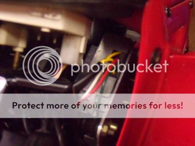

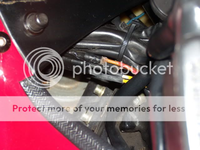

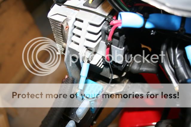

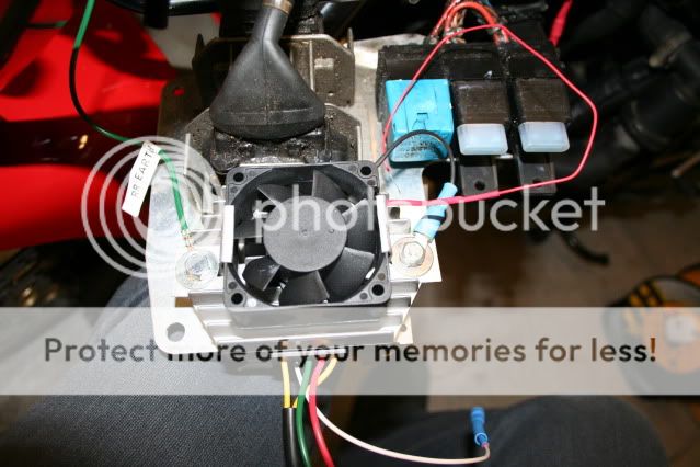

Ok, here are some pictures. On my bike ground wires from the regulator are grounded at one of the bolts that attach the regulator, that is where I ran the ground wire for the fan. The regulator had some extra material molded with the cooling fins that were an exact match for the mounting screws of the fan, (humm, forethought?) I drilled and tapped the four places for the fan screws. If your regulator doesn't have these places, use a metal tapping screw that is just larger than the space between the cooling fins and screw them in between the fins. I ran the positive wire of the fan into the positive/battery wire of the regulator where the regulator wires plug into the wiring harness (see picture) with an in-line fuse just like for a radio.
First picture is the plugs at the steering head where the regulator plugs into the wiring harness.
Second picture is the fan mounted on the regulators cooling fins.
Third picture is the fan again
Top view of the regulator and the fan (with the front fairing/windshield removed)

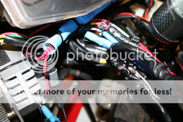

I have used large bullet crimps on the cable ends, then solderd the connectors as well, then covered with heat shrink.
Also fitted the additional earth.

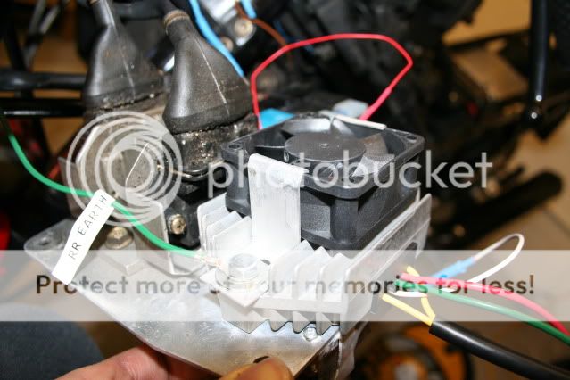

The only bit i may have got wrong was where to pick up the 12dc for the fan, when i connected to the
+ve of the RR, the fan ran all the time with ignition off :oops: .
I managed to pick up a 12dc on the switched side of the ignition switch,there is a Molex connector (situated below the headlight) on the cables from the ignition, i was able to remove the pin and solder on a wire, Job done !!!

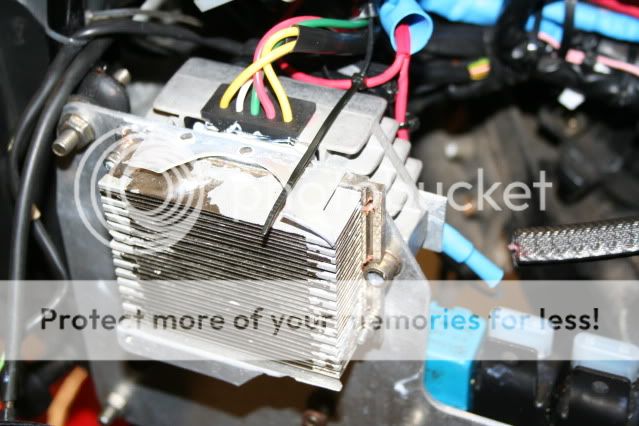

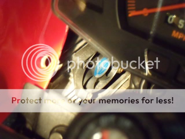

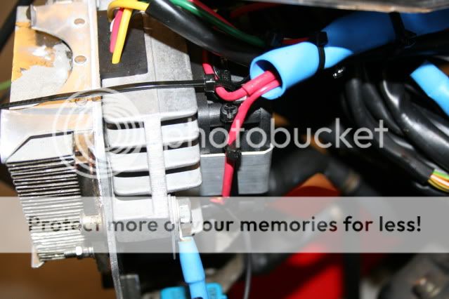

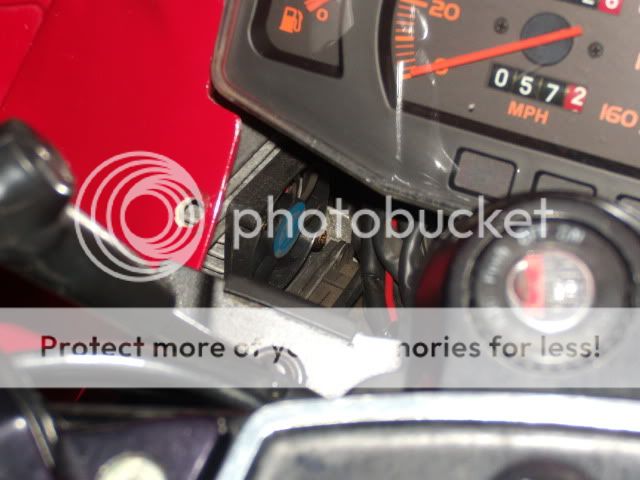

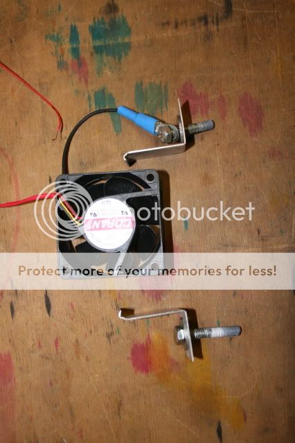

Here are some pictures, (if i manage to post them), of my labours !
Top Wiew
Fan Clamp made from old heatsink Fin
Fan & Clamps
Fan & RR in situ
RR Wiring
Additional Heat sink
View of additional heat sink
Regards
Bomber
