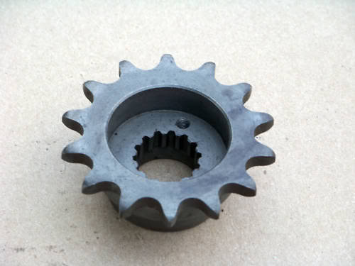

the P750 sprocket

as Terry and I are discussing this topic offline here a short summary of our current thoughts:
a sprocket like this would be nice, but according to Antti this could be from an early 750 Sport or similar and is quite rare. In fact I didnt find it listed ie at AFAM or JT sprockets.
(if someone has some info about this let us know!)
I personally don`t like the before mentioned option 1 as I don`t trust the center bolt only.
Option 2 has by far too much offset and overhang of the drive shaft. Material could be removed from the sprockets back and the inner sprocket/adapter flanks but this would be approx. 4mm max. (still 7,5+mm offset). Downside this would need to be done with every new sprocket.
As Terry has a 748 sprocket the idea was then to reverse it. Depending on if the inner sprocket/adapter was recessed or flat the gained offset would be around 4,5-6mm which should be fine in most cases. (To compensate the overhang one could have a small prolongation of the drive shaft fabricated)
A recessed sprocket/adapter would be an original Paso sprocket with the teeth removed, a flat one an original Paso sprocket with the sidewalls removed or an 748 sprocket w/o teeth.
The advantage of this solution would be that one would need only one or two parts made by a machine shop once. Then when replacing the sprocket one would only have to have the threads drilled through of the new sprocket.
Currently Terry is leaning towards option 4, I towards option 3 as my setup is different.
Seeing that newer bikes like the 749 have a flat round retainer clip this will be the next thing we`ll check. Thinking that a bigger surface area between the 2 sprockets is better the next step would be to check if this retainer clip is flat and has the identical width as the one of the Paso. If so it would only require 2 holes drilled through it. But it looks like the outer part of this clip is sheet metal and too soft to use it instead of the original one.
Any thoughts on this matter are highly appreciated.

As Gerhard stated, we've been burning up the server with Private Messages while discussing this instead of throwing our half thoughts and partial ideas into the forum that may confuse people....and probably by quite a bit.
I think we are to the point of us having to do one of these conversions and try it out. Gerhard may have his system completed within the next week and it may take me a week or two to get all of mine done by a friend who find time between projects at work. Our two systems will be very similar with the main difference being the recession being left on the OEM Paso sprocket or having it removed. I believe we both will come up with a slight shaft extension to be bolted onto the end of the shaft with a single bolt.....more of a "peace of mind" thing than anything else.
Looking at the 748 sprocket, it is not as easy as just cutting the teeth off. The sprocket and mounting boss is nearly twice as wide as the OEM Paso. Putting the 748 sprocket onto the shaft has it sticking out far enough that it is almost flush with the end of the shaft. Looking through my old sprockets, using a 748/916/996, ST2, ST4, or M900ie sprocket as the one that goes closest to the engine case would require machining its thickness down by at least 4 mm and probably closer to 5.0mm.paso750 wrote:A recessed sprocket/adapter would be an original Paso sprocket with the teeth removed, a flat one an original Paso sprocket with the sidewalls removed or an 748 sprocket w/o teeth.

Got one of those lying around.paso750 wrote:as Terry and I are discussing this topic offline here a short summary of our current thoughts:
a sprocket like this would be nice, but according to Antti this could be from an early 750 Sport or similar and is quite rare. In fact I didnt find it listed ie at AFAM or JT sprockets.(if someone has some info about this let us know!)
