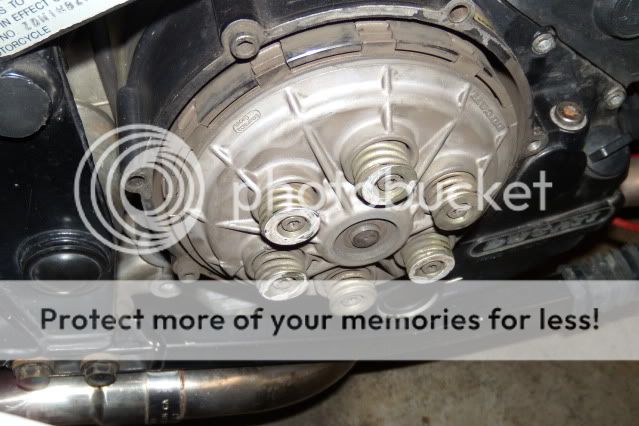

2. Below are a couple of pictures of the inside of my clutch cover and a rubber gasket from a 900ss (I'm using it as a spacer). The retaining caps for the clutch springs where rubbing the inside of the clutch cover after I installed a new clutch housing (newer part number). I had noticed the original 907 clutch housing was flater at the bottom and turned up squarer that the new part number housing which was rounder at the bottom. Its the same housing part number that most Ducatis use. It's my belief the updated part number clutch housing moves the clutch plates more to the outside causing the clutch spring retaining caps to rub the inside of the cover. So I installed the gasket to act as a spacer and move the cover out to increase the clearance, but that also makes the clutch cover move out rubbing the underside of the fairing.
