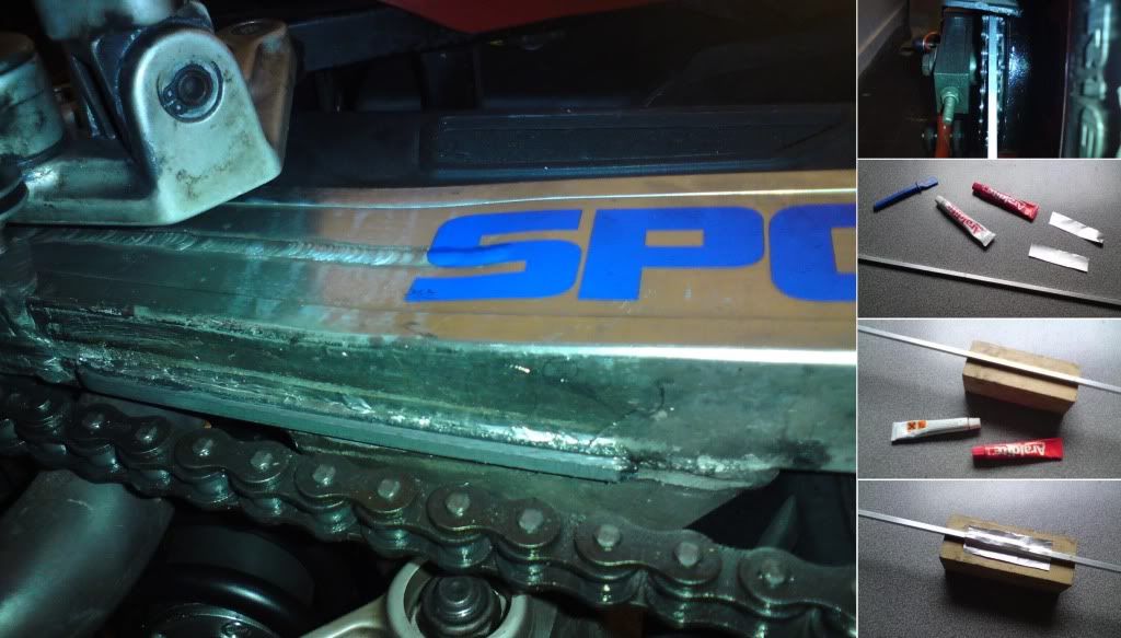

I thought the chain roller guide was Ducati part number 037040230. Nevertheless if you get a meter of 5mm square section Aluminium bar, Araldyte and tin foil I can show you a wonderful way to make a new chain guide for your swingarm!

chain glide rail
Post by JWilliam »
The picture shows you how to make a chain guide on your swingarm - you might rermove the swingarm to do this. A 5mm square aluminium rod will fit between the chain plates and rest on the rollers. Pretending that the wooden block is the swingarm, having cleaned the swingarm, glue the rod onto the arm between the twin grooves worn by the chain. While the glue is still wet, overlay the foil strips onto the work to prevent oil contamination of the composite glue. I decided against welding because the welding could melt the 5mm rod and if it needs replacing its just a quick bash with a hammer and its off rather than cutting it off and risking damage to the swingarm. Don't worry about it coming off in use, it wont.
