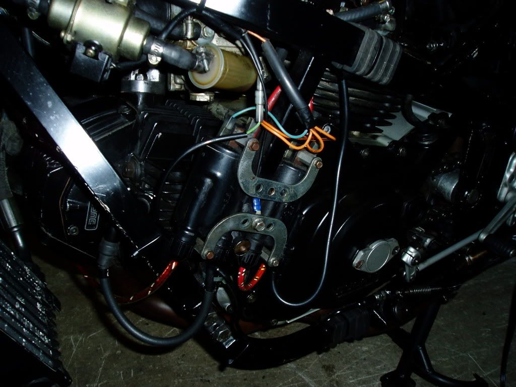

Re: New Paso Owner

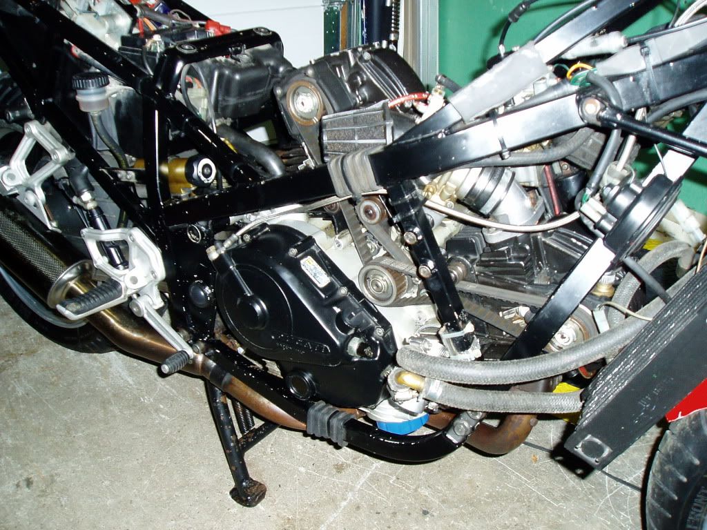

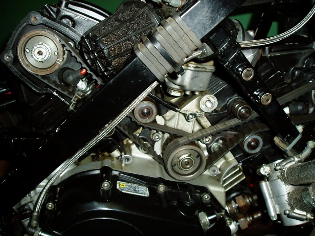

It appears to be a 750 ( engine serial starts with ZDM748 A2C).Definately a wet clutch motor. Sorry I haven't gotten pics up yet. I'm still trying to clean up all the grime. From what I see it looks like a straight bolt in. No odd brackets , spacers ,etc.

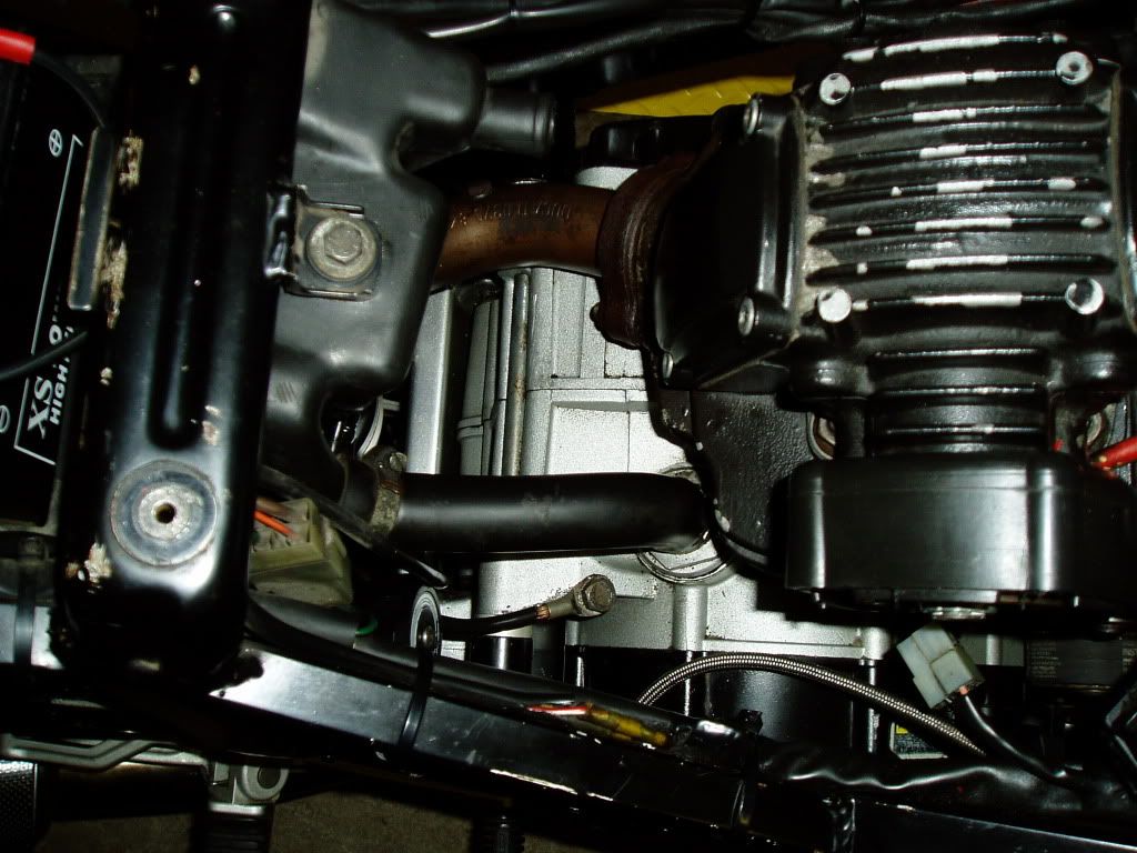

Re: New Paso Owner

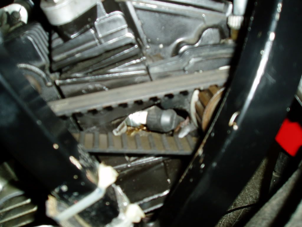

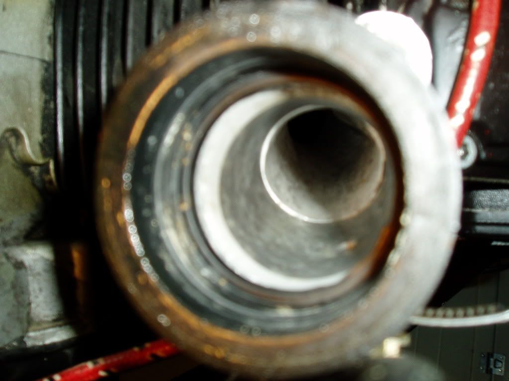

Cleaned the carbs last night and found some clean up work on the intakes. IS this normal or someon'es handy work wth a dremel?

Re: New Paso Owner
Ike,
Indeed - clearly a wet clutch
I reckon you may have an early 750SS engine there (with the narrow crankcases at the swingarm so it fits without machining). I checked my 1991 750SS engine which has these early type crankcases (but which has a dry clutch, from before they switched to the wet clutch of the 600SS). My engine number starts the same as yours (ZDM748 A2C) and is a number less than 350.
M750 Monster engine numbers were the same but they all had wet clutches(?) and wider crankcases at the pivot (used the 851 swingarm I think?)
Strange mix of side covers though. Older alternator cover than on my 1991 750SS engine but a newer style the same as my 1994 600SS on the clutch side!
Nice Bike!
Mick
Nice Bike!
Mick
906 Paso 1989 w/ 17in wheels

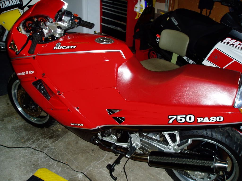

Engine have changed later surely. Fairings have those "controlled air flow" stickers and silver colour upper triple clamp, so your bike is very early one 750 Paso(no matter it dont have Öhlins, but Marzhocci in rear) and THAT time Ducati factory didnt think YET any 2 spark normal production engines as such came VERY many years later. Engine seems to be some mix from later SS/Monster engine as it have silver colour cases. They use silver colour cases in 90's in SS at least. I have one such 750 SS engine from 1997 but my engine have silver colousr clutch and alternator covers. I quees, Your engine is rebuild from many Ducati engines...

Nice carbon silencers, do you know what brand?
Re: New Paso Owner
They say BOS on them .Never heard of them. I've been able to contact a previous owner. hopefully he'll shed some light on the history of the bike.
