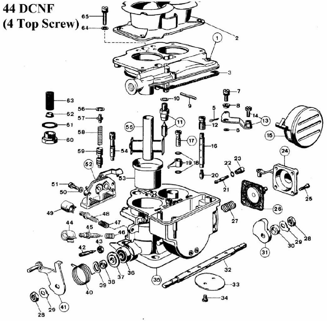

Didn't know which part of the forum this should go in...
Here's a parts diagram for the 44 DCNF. It's not exactly as our carbs are cause it looks like there are no top studs listed where the air horns mount on the carb.
