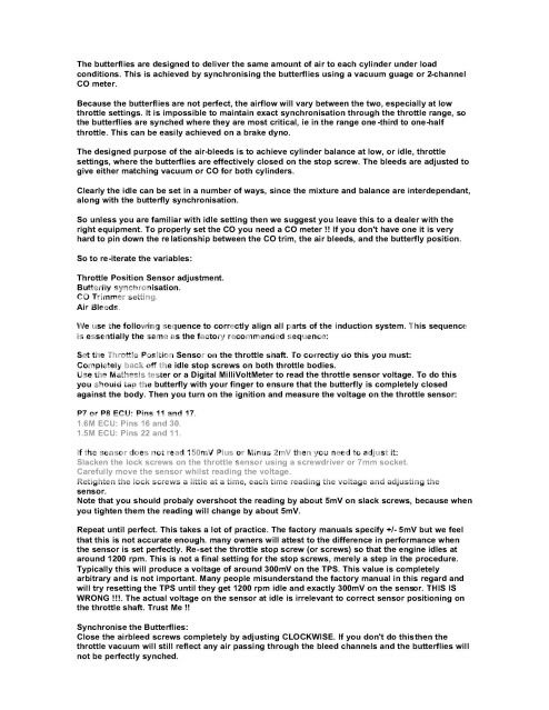

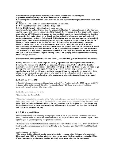

- du907
- Posts: 346
Re: 907ie idling high! Help?
First thing to check when all of a sudden it starts idling high is does it do it after riding or after warm up. If so check the cooling hose on the left of the frame as it passes by the cold idle mechanism on the left of the throttle bodies. This hose, as it gets older, expands and can rub againist the nut at end of the rod the butterflies are on through the throttle bodies. I used some rather large zip ties side by side installed when the hose is cold to keep it away from rubbing the whole mechanism.
Next, if you adusted the set screw that syncs the throttle bodies you have screwed up. You can actually access the left side idle set screw (there are two, one you can't access without removing the air box) from the front of the motorcycle over the radiator with a xtra long screw driver or long extension with a 7 or 8 mm on the end.
Anyway, check the old FIM site or maybe this site has it archived but FIM did a step by step on how to start from the beginning and set the TPS, then sync the throttle bodies, then balance the idle with the air screws and a turn of the adjustment in the ECU under the seat. If you can't find it let me know, I have it somewhere. I have done all this myself and it's quite involved but can be done. You have to do all the steps in sequence to be successful.
But it works. You'll have to get a vacumn balancer and some extra fuel line so you can run the engine with the gas tank off and out of the way but still hooked up to run.
du907
du907

OK Higgy, call my bluff! From the old FIM site.
