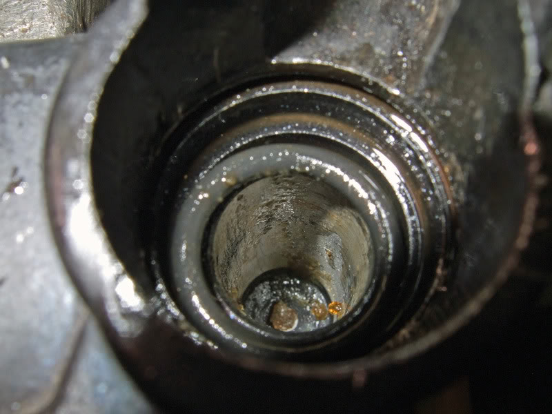

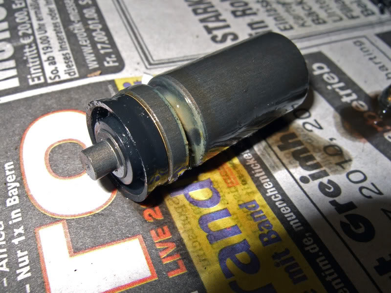

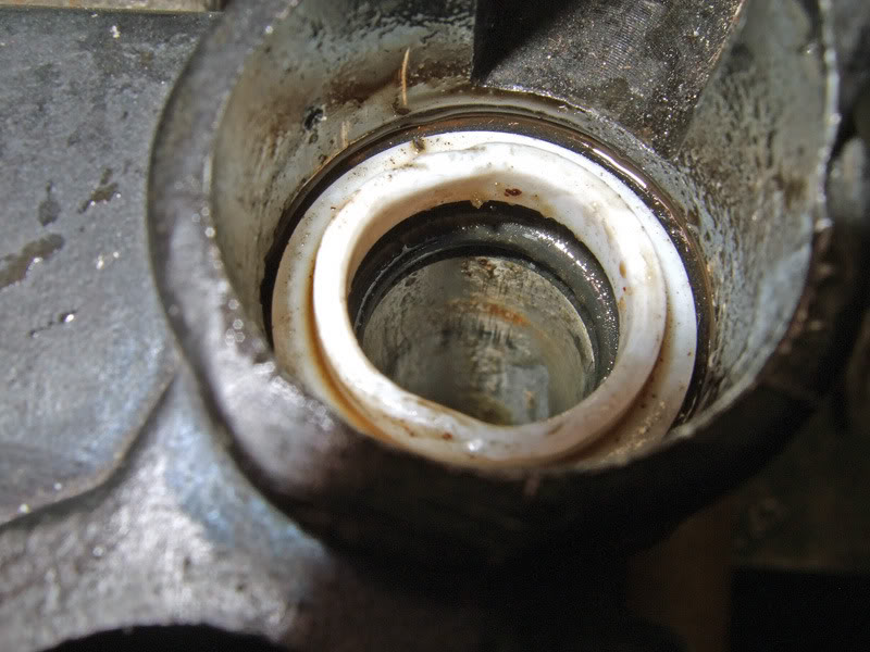

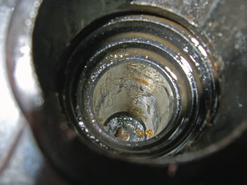

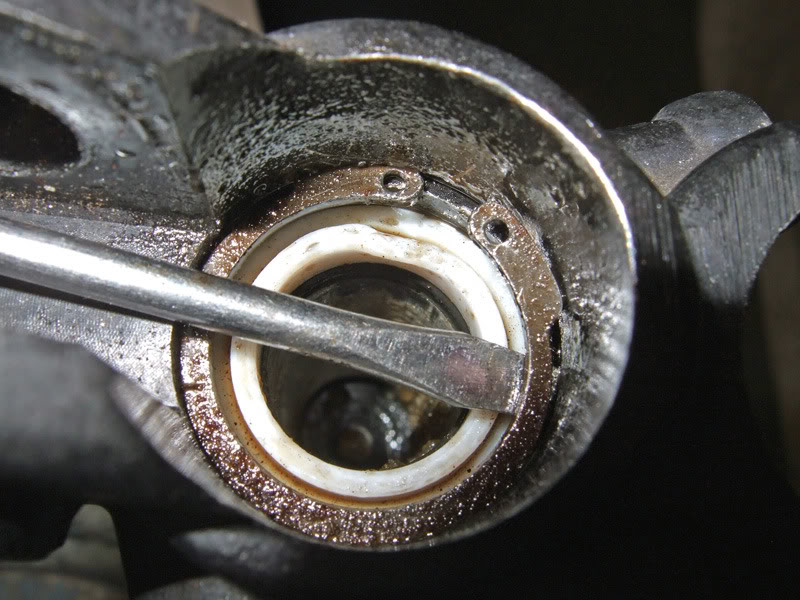

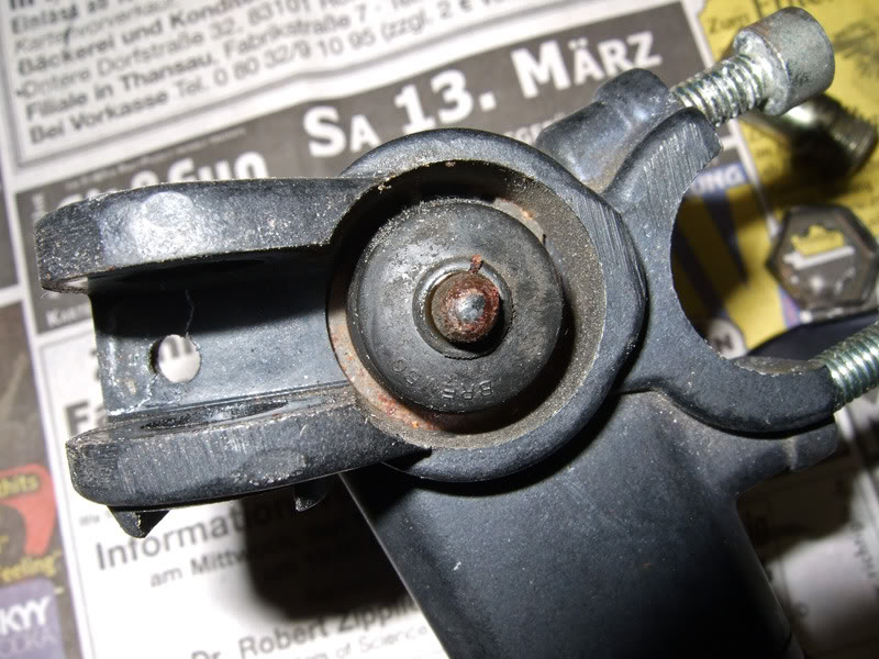

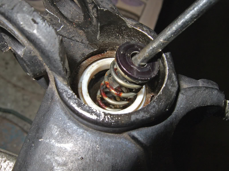

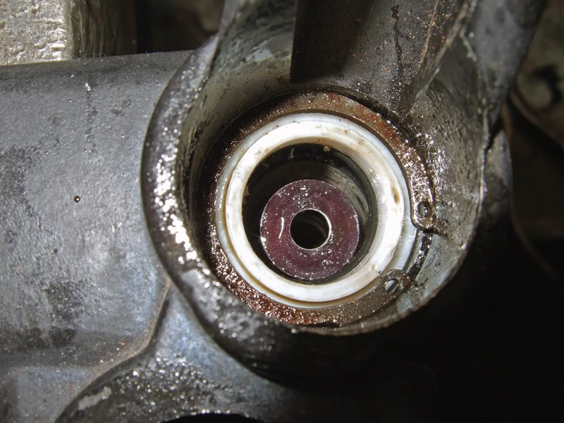

here you go. I disassembled two broken pumps so ignore the way I did it :)
The condition of your cylnder is much better than these two.
The O ring sits on the outer end of the cylinder. Then comes the white plastic ring with its wide side towards the O ring. Pulled over the plastic ring is the dust seal and then comes the circlip.
Now you know what do do :)

Assembled the master cylinder using G's pictures and the Brembo instruction sheet and filled it up with brake fluid. Started bleeding and had lots of air bubbles coming up. Beautiful! :) Then: fluid coming from the side of the lever. Aaaaargh! :banghead:
Taking the cylinder apart (I can do this in one minute flat now :lol:) I realised there is a space between the circlip and the plastic ring if I put the parts in according to the Brembo instructions. This allows the rubber ring and the plastic one to move and, I'm assuming, fluid to get through.
However, from G's pictures, and taking the cylinder apart the first time, it seems the rubber boot sits under the circlip. This would prevent the other rings from moving and seal better. :idea:
So we'll give this another go and put it together again. After that I'm going to have a lot of beer and a little lie down.
yes, as pmed it`s O ring, plastic ring, rubber seal, circlip (from inside to out). The rubber seal is pulled over the high edge of the plastic ring.
My circlip pliers were too big for this one therefore I had to tear out the rubber seal before removing the circlip.
