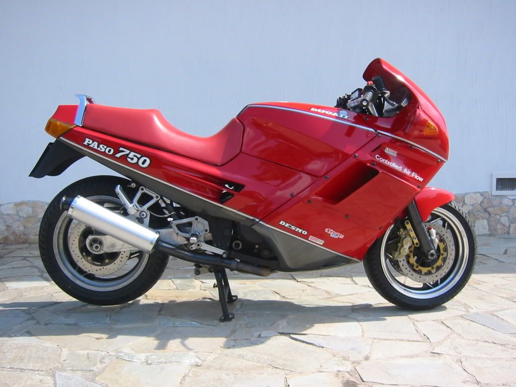

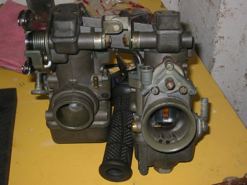

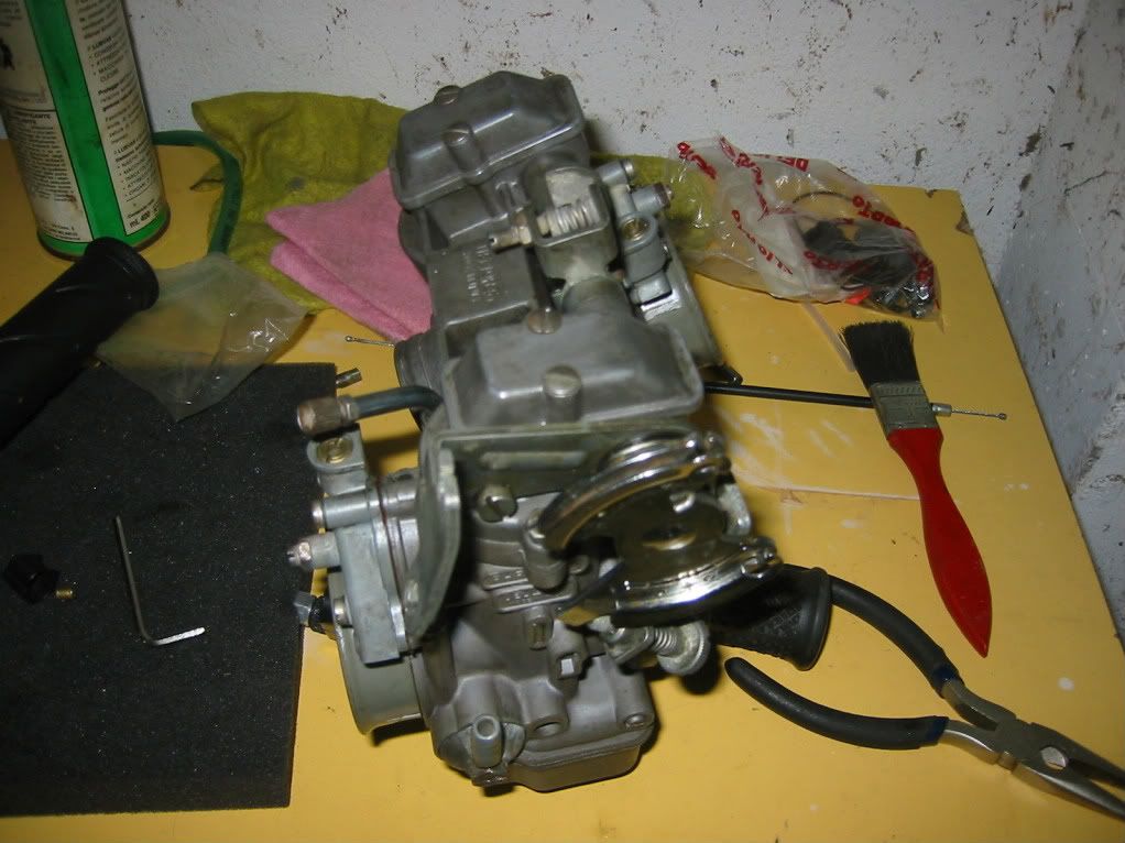

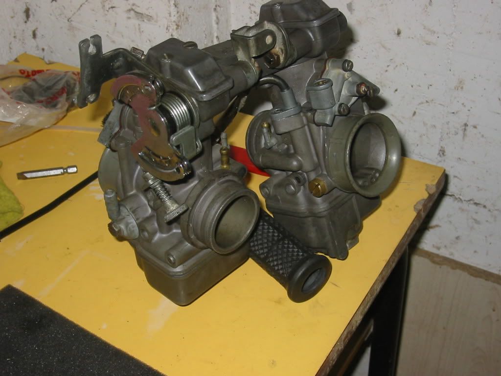

Hello everyone! I want to install the 36 Dell'Orto PHF carbs single command (see photo) Does anyone know what kind of manifold I have to use? (Ducati Indiana? Cagiva Elefant?

There is no manifold set up that will let you keep them joined with one cable, that I know of. If you split them up, then you can use the Malossi manifolds, which are similar to the Pantah motors manifolds. The Mikuni carbs on later models are down draft, not side draft, so those manifolds won't work with those carbs. You may need to get new caps for each carb to remove the rocker assemlies. I think the slides should adapt just fine.
