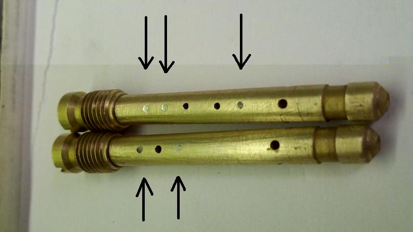

After following your tuning tread I checked all my jets. Idles 57, AC 170, Mains 150, Starting jet 110F7. And check out the tubes(incase pic doesn't come out right... arrows are the soldered closed holes).

Re: Weber 44 DCNF part help
I`m everything but a carb specialist but the same jet setup is not necessarily the right one specially due to the lack of an airbox.

As for your frankenstein emulsion tubes well I wouldn't be too concerned just yet,but for your curiosity here's my setup.
Starting from the top side of the little step that the air corrector slips down to and measuring down the tube (the join line between the emulsion tube and air corrector in your photo)
my rows of holes measure as follows.
(lower side of step tube outside diameter 4.7 mm)
13.5 mm to centre of holes,4 holes @ .8 mm
(14.5 mm the diameter of my tube increases by 1mm at this point to 5.7 mm)
15.5 mm to centre of holes,4 holes @ 1.0 mm
20.0 mm to centre of holes,2 holes @ 1.0 mm
As I said don't be concerned with your tubes until you get everything else sorted.You probably won't end up touching them,I placed a lot of emphasis on them ,when I should have been looking at the pump cam instead. :banghead:
