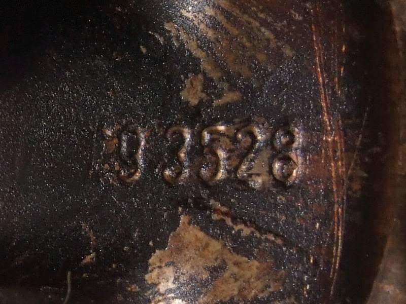

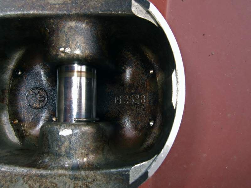

Arrrgh!!!! The dissassembly went without a hitch, but, SURPRISE!!, I think the previous owner had already put hi-comp pistons in! The pistons I pulled out are identical to the hi-comps I ordered, and even have the same markings underneath: 09 3528.
Can this be possible?

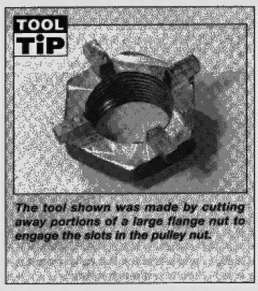

Yeah, waiting on replies from one other source. So far three other sources have been no-go for the parts I need. As for the cam pulley tool, anywhere I can find it for less than the $80 most places want for it?

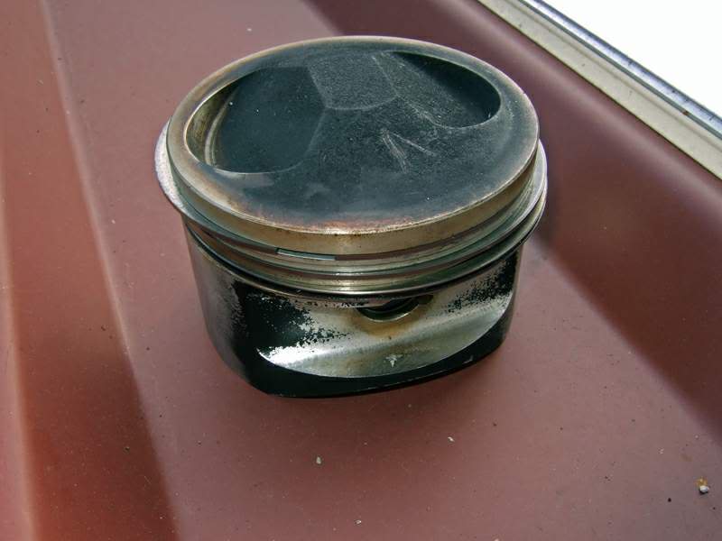

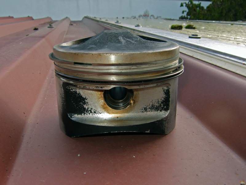

I'm a bit confused.
The Paso 750 manual claims a CR of 10:1; is this correct? At several sites I've seen specs as low as 9.3:1 for the Paso 750/ F1 750, and 9.5:1 for the 750SS of the same years. If the posts on this site are correct, then the Paso/F1 have the higher (10:1) CR and the SS/M, lower CR. Ok, I got it. So, are the two identical sets of domed pistons sitting on my bench the stock (higher CR) Paso/F1 pistons or are they higher (than normal) CR for the Paso/F1...how do I tell them apart? One set was already in the motor, the other I bought as "high-compression Paso 750 pistons". Did they mean 'higher-than-stock compression, or were they identified as "yes, they are high compression pistons, beacuse they came from the Paso/F1, sir."

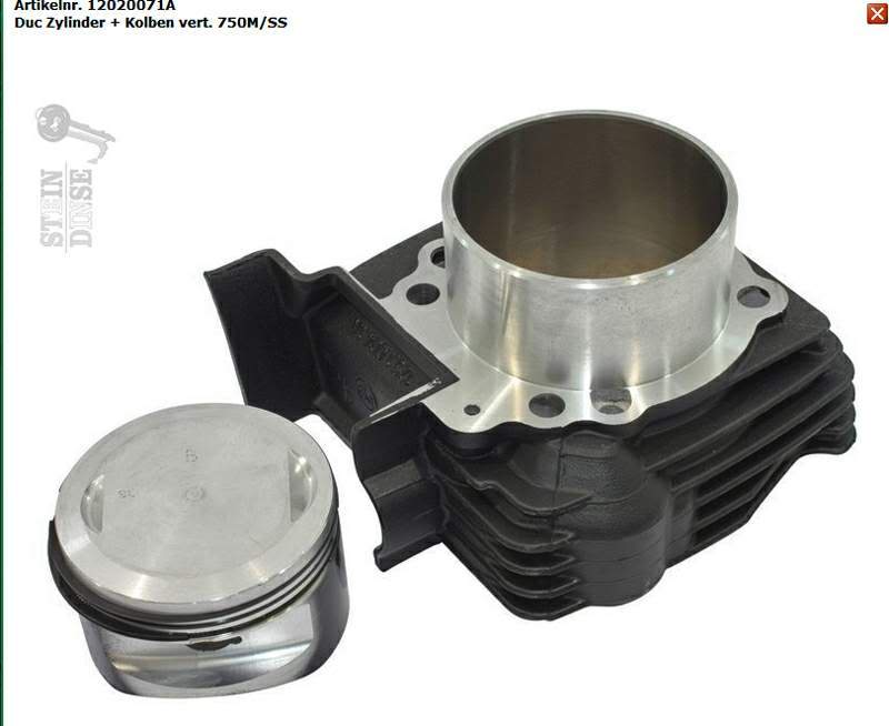

Here some pictures:
these are original 750SS/Monster pistons:
The original Paso pistons can not be bought from Ducati anymore.
