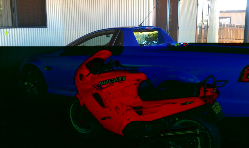

Afternoon All.
Thanks to those who have posted replies. I thought I would add a picture of the 907 and answer the questions too. Also a couple of things I forgot yesterday (CRAFT setting in?). And like all good things, more evolution too.
The 907 has a set of Staintune Mufflers with what looks like the original headers. Another funny one here. Where the 4 pipes of the headers converge, there is a nice plate welded in the gap. It catches all sorts of crap including the odd drop of oil. Makes you wonder? The bike also has a non standard chip in the ECU. No idea what make or version? It does disable the the ECU trimmer. Or maybe I should say the ECU trimmer doesn't do anything, which could possibly have been disabled by the Chip?
After thinking about it last night, it sort of makes sense the ECU cuts the fuel pump if the engine isn't running. Thanks for the reasons for this giarcg! Job number 1264 is getting the injectors cleaned. I head east next month for the footy, so will take them for a holiday to a Workshop there I have heard good things about. It can't hurt.
A couple of other things I have done over the last few weeks was swap the coils and plug leads over (Horizontal to vertical and vice versa). Try and move the fault but no luck. It still looks like the horizontal cylinder is the misfiring cylinder. I was sort of hoping I wouldn't have to get too serious with the valve train to soon. My background is electronics (the real stuff, not the virtual stuff), so my mechanical experience is limited. There's not too many Ducati dealers around here either. Oh well, you get that. Time to learn....

- Ducati 907ie.jpg (92.23 KiB) Viewed 26652 times
