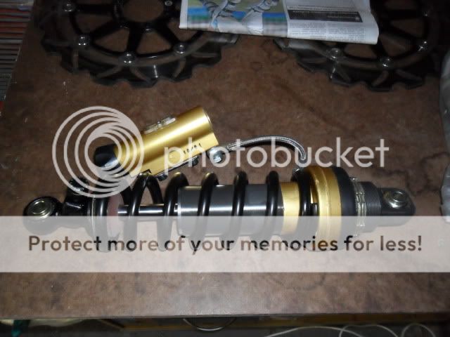

Hey there K6,get hold of ROBERT TAYLOR at crown kiwi technical (CKT) in newplymouth
new zealand,he's our local ohlins guru who also spends alot of time setting up
suspension for the racing fraternity.
He supplied a ohlins shock for my 907 so will have spec's allready to build more,
and i must add they are worth every cent,i opted for remote spring preload,
it's just awsome and that gold bit on the side looks reeeealy trick
Don't waste time,if you can aford it do it!Cost me $1500 nz,about 900 euro.

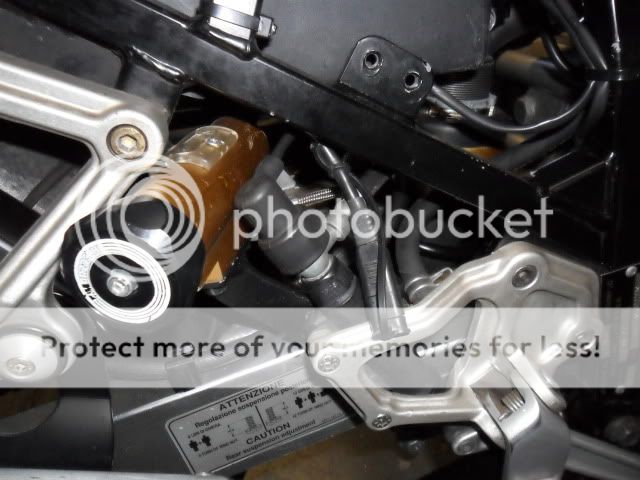

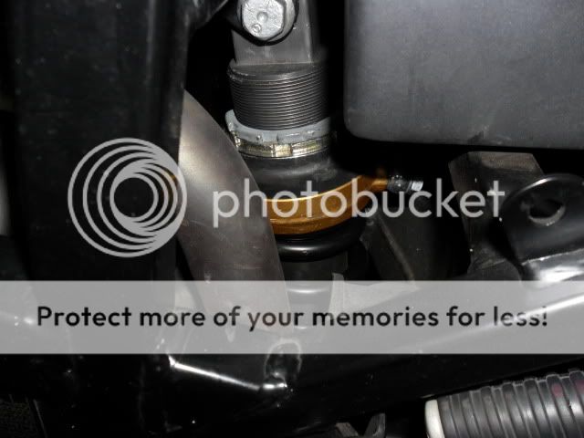

Hi davo,as youwould agree there really isn't much to see apart from the gold
hydraulic preload adjuster mounted behind the right pillion peg hanger(i hope
this explanation gets me out of TRYING
to put up a picture
The bike handles really well,i have a thirty k ride to work when the weather
is kind and the road has some good testing parts for suspension especially
at speed and the ohlins really improved both comfort and stability,it only has
rebound adjustment (no adjustment offerd by robert much to my discust but
he assured me i wouldn't need it!
and bugger me if he was spot on
i didn't adjust anything after installing,the sag and static sag were within half
a millimeter and that compression damping seems right for fast or slow/sharp or
gradual bumps,robert said the internals of ohlins gear is pretty clever and i don't
doubt that now,all i have to do now is get the front end up to him to work his
magic so the front kind of matchs the rear
