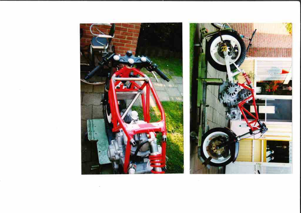

Hi Higgy,
you're right. I did this a while ago. Due to lot of things I didn't finish the project sofar.
Removed all the unnecessary iron and braced where required
shortened frame gereduceerd.jpg (49.23 KiB) Viewed 60843 times

Mustang505
