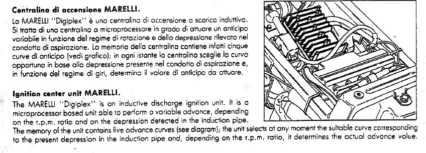

I'm an original owner Paso 750 owner broke my back in 93 after only have put 4k miles on my bike. My daily driver was an 88 gsxr 1100 the bike I got paralyzed on. Any way I have a question. There is what appears to be a vacuum tube going from the base of the carb to an electrical box just behind the battery in the electronics tray. Any clue what this is?

Don, that indicates you have a Marelli Digiplex ignition.
Here`s the explanation from the 906 manual:

yup basicly vacume advance line
