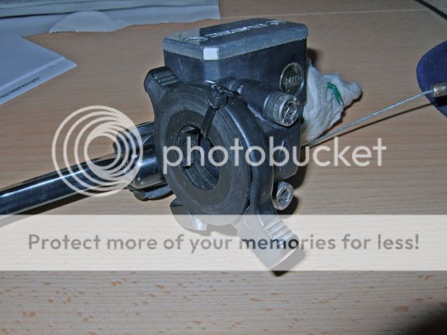

This is where the choke is turned on:
(lever all the way forwards, or turned counter clockwise, viewing bike from kickstand side)

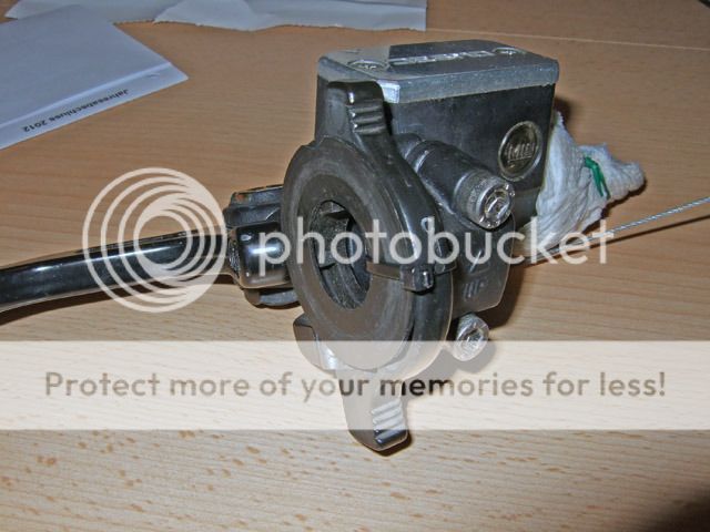

This is where the choke is turned off:
(lever turned clockwise (right from side), 1 click clockwise means less choke?, and 2 clicks is completely off)
-photos courtesy of 750
So the bike will idle with the choke on at around 2000-3000 usually. Why does this fluctuate? It seems to start at 2000 and go to 2500, or sometimes start at 3000 and not move much, and when I first got it it would be higher I believe, like start at 3000 and then rise higher, to 4000 or so. Should it be rising higher than 500 now, which means it is warming up and I can turn the choke down?
