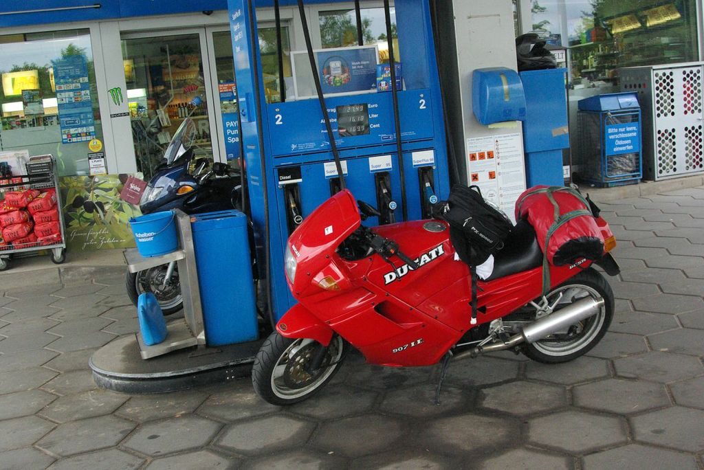

Hi all, fitted the Garmin Zumo 350 LM to my 907 i.e. this year.
I replaced one of the bolds holding the handle bar and front brake fluid reservoir to the top plate of the front fork by a RAM-mount bolt. On this I use the longer RAM connection device (10 cm) so I can move the Zumo to a position behind the screen and not block the instruments in the cockpit. As the steering turns the Zumo turns too, make sure it does not run into the front fairing.
Fit it close to your right hand for simple operation during driving (not preferred)
Works great for me, easy access, easy to install / remove and minimum modification. The black RAM-mout is hard to see with the black metal handlebars. Nice Allenbolt for replacement, labeled the original bolt and stored it away. Cost were low as well. Check out this site for an indication on product and price
http://www.ram-mount.co.uk/1-ball-motor ... 8_286.html
Need more detailed close up? Please let me know and I will post some pics.
In this pic you just can see the side of the Zumo during a tank stop against the blue colomn.

- Tankstop Germany filling the 907. Running 1 ltr on 20 km ;-)
- qNh-TO0O1cLoMAJk8VmKhjggX_cttAWjBGVEao3xkZo,gSCAjls_I9mopOdTTWVXcT-rBifqyfyU6KOMwB05XwU.jpg (144.12 KiB) Viewed 18059 times
