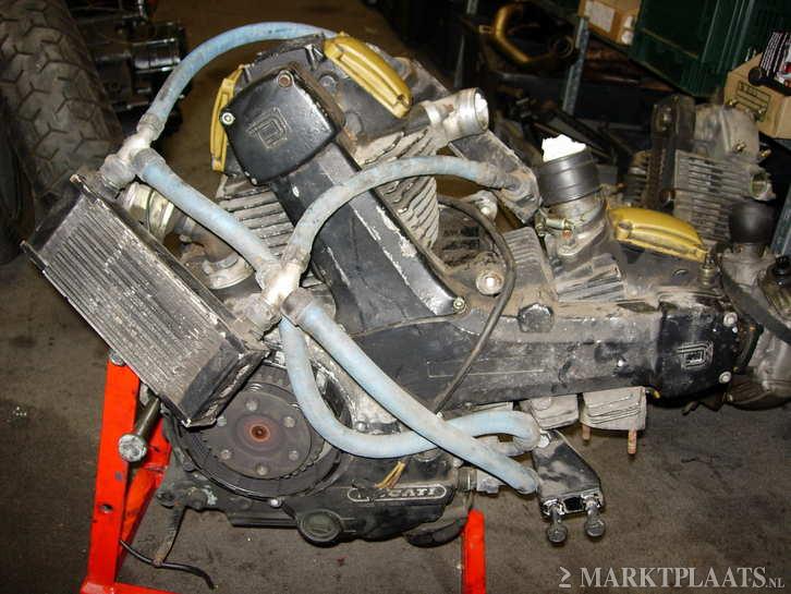

Tx. I'll have a go at a spare engine. It's one of the latest 750 models. Looks like crap, but a solid base to start from. In the meantime I can ride the paso with the current engine.ducapaso wrote:ok, it will take some time! Have a nice job!
