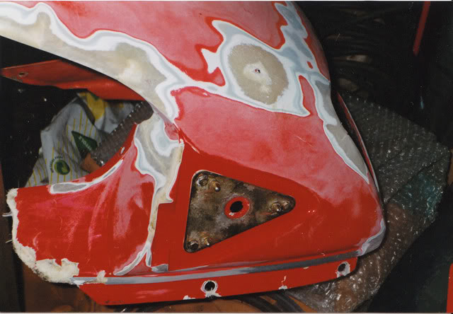

Be careful what lurks beneath ....I had 17 coats of paint from probably at least 5 resprays on my top panel shown below and even more on the other Using paint stripper is okay on the first few coats just don't leave it on for too long and wash down thoroughly when you are finished.
If you have any fibre glass repairs though you may weaken them and have to start afresh.
Why not just 120, 180 then 320 and 400 grit wet and dry flat with a air sander and elbow grease and then primer filler coat and respray?
The panels are made from fibre glass which are they are press moulded with lots of chalk in the resin to act as a bulking agent - press moulded means there are two moulds one for outside plus one for the inside to get the smooth inside surface, not quite as simple to repair as a hand lay up with fibre glass matting but doable, you will need to grind behind the cracks deeper and wider to get good adhesion and maybe lay in some wire to strengthen.

I fixed my side and front fairing (P750) and it`s still fine after 13 years.
- crash3.jpg (59.27 KiB) Viewed 15089 times
