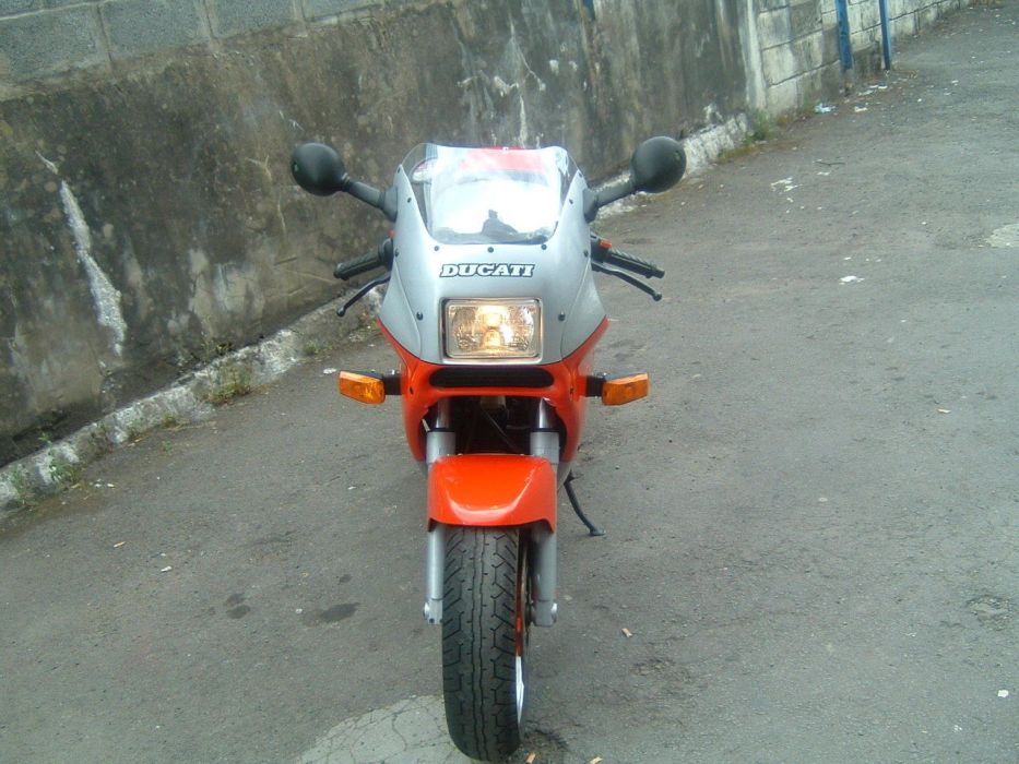

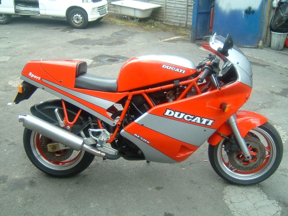

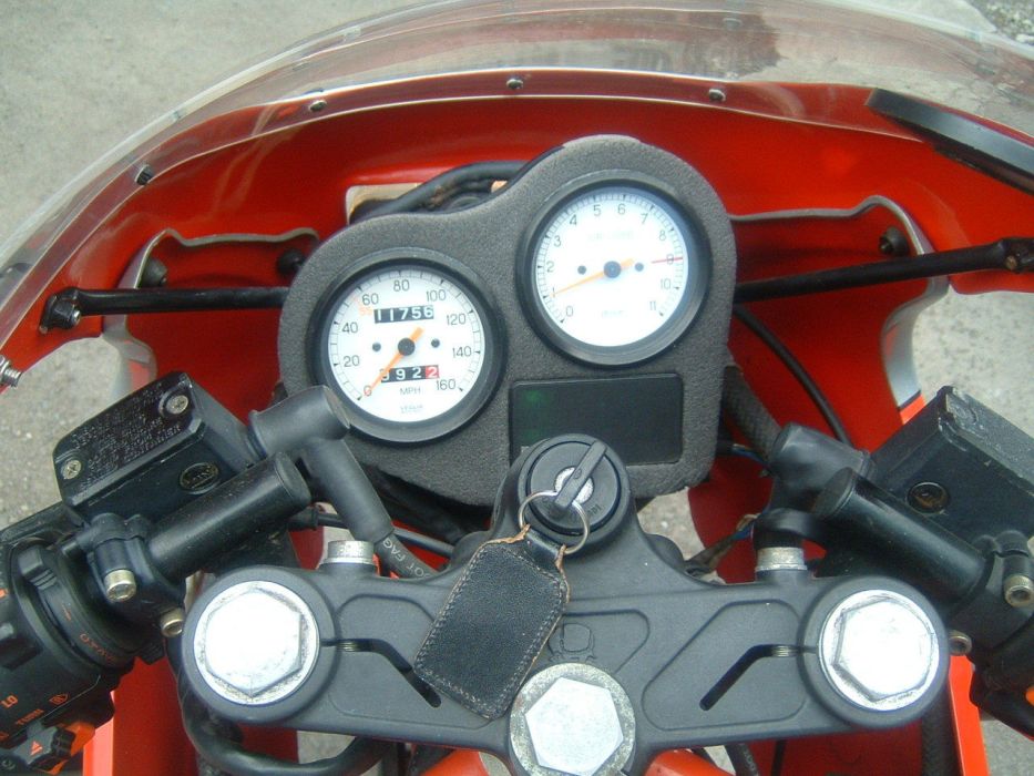

Re: 750 sport help with part up grades
Peter... Pics attached.. i think...
Tony
Im going to keep the stock Webber... do you know where I can get some nice flutes or horns for the top of the carbs?
Tony
That's a nice Sport Tony.Do yourself a favour and check for cracks in the swingarm.They are renown for it.

mind you, that is the later model braced swingarm so it should probably be OK.

Great looking bike by the way, well done.
