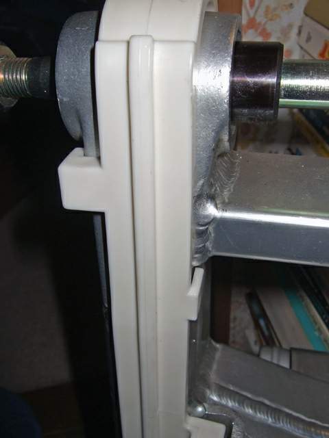

That`s interesting. ... do you notice something on the pictures ?!
Ken and I compared the dimensions we measured which means the new chain sliders are the same as the ones we have but the swingarms aren`t.
Yours is a 907ie swingarm while mine is for a P750/906.
The two have a different chainline. I had the suspicion it would be so but I thought the chain sliders would be different. But if you look at the pictures the bracket the slider mounts to is offset more inwards on my swingarm.
As that side nose is in the air on your swingarm while I had to cut off mine I`d assume the chain sliders for the 907ie and P750/906 are not identical and you have one for a P750/906 while mine is originally for a 907ie.
PS: another small difference: some are cut off flat in the front like mine, others aren`t

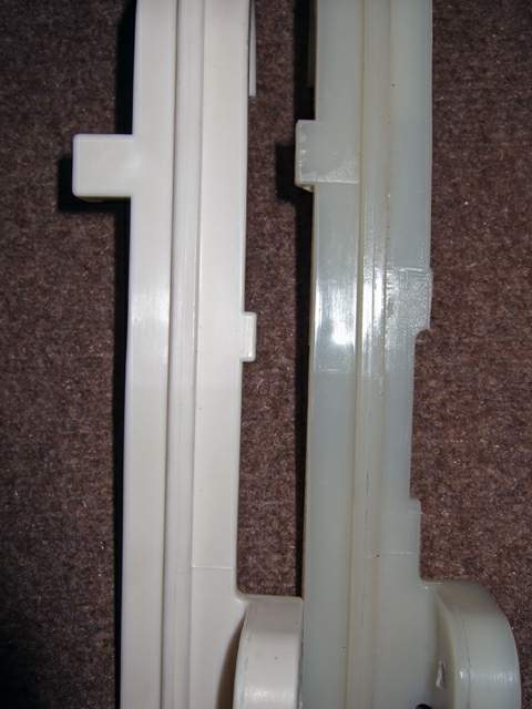

Looks to me like all 3 sliders are basically the same. Relief contours and the shape of both ends may be slightly different and the 906/750 slider has the extra tab but that's of no consequence to the way it fits the 907 as it can be cut off or just left on.
Looks to me like we have a one size fits all situation :thumbup:
750/906 on top
907ie on the bottom
btw the reliefs appear to be hand cut in every chain guard I have(4)
Re: swingarm chain slider
Both of my new 907ie chain sliders have two tabs (with which they would't fit on a 750/906 swingarm) but there might have been different versions. Maybe the design was changed or Ducati changed supplier once, who knows.

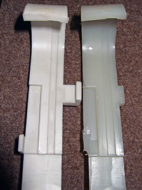

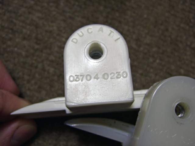

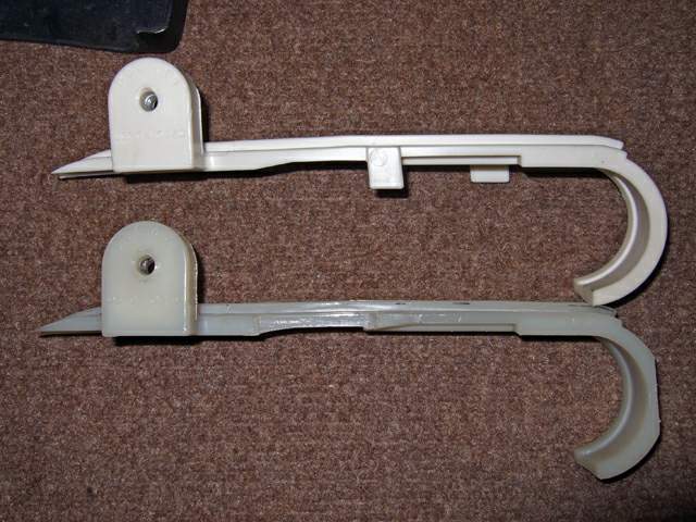

this morning I received a new original swingarm chain slider which I found recently.
The interesting thing about it is that it has the identical part number like the one I already have but there are several differences.
Image[/url]
Materials are obviously different. The white one is the one I just got.
This one fits perfectly on the P750 swingarm and the side tongues are in the correct position
Not so on the old part
The outer tongues has an offset, while the inner one doesn`t. On the old part it`s exactly the opposite (I had to cut them off)
The inner tongue is not in the same position and the new part also lacks that cut-out
Furthermore the new part isn`t cut flat in the front
While both are original and have the identical part number the white part fits perfectly on the P750 swingarm while the other one fits on the 907ie swingarm which must depend only on the different offset of the chain slider mounting bracket on the swingarm. This ads to the list of weird & unexplainable things Ducati did back in the day ...
