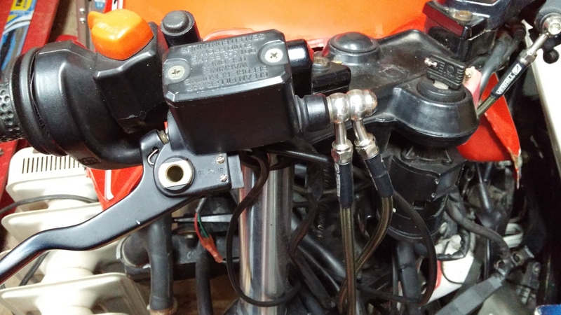

I went with the Venhill and ditched the splitter. Got a microswitch from Bevel Heaven to keep the brakelight on my 906.
- 0421150608a_zpslmsr1wxy.jpg (215.8 KiB) Viewed 16557 times
