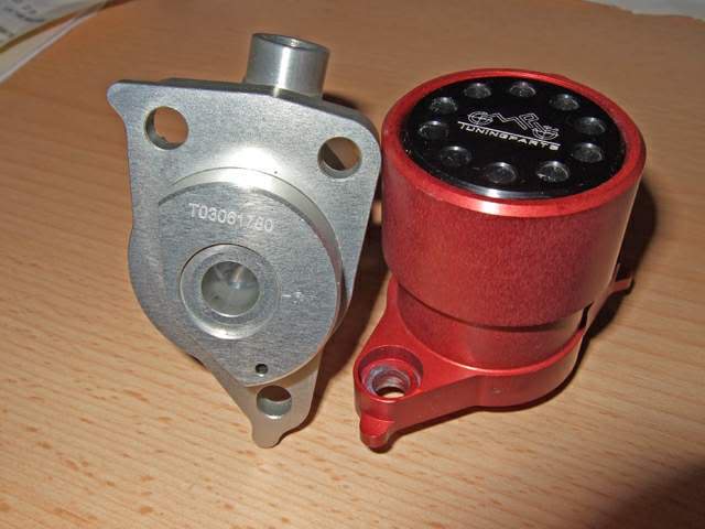

This is btw the clutch slave cylinder from MPL which Stein Dinse sells for €148.

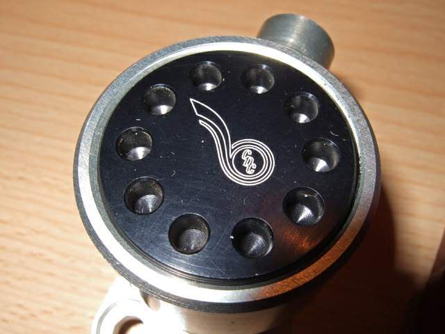

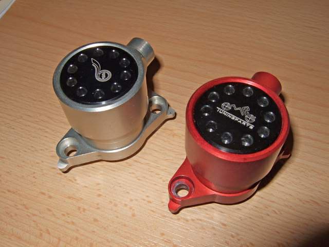

looks like MPL recently had a small design change as the outer edge now has a different bezel.
Before they looked identical to those ones in the UK. I wonder who the actual manufacturer of these things is. I have one that says "MPL", another "CDC" and the ones on ebay are "Factory racing".
