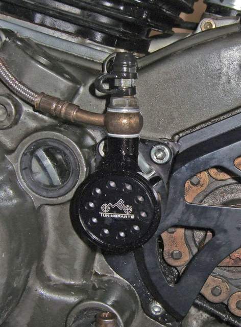

looking around for clutch slave cylinders I`ve seen these ones. They reduce clutch lever effort and cost less than the original units (some used do cost more). They come with the adapter piston so they can also be fitted on Ducs pre 2000. Maybe someone is interested.
These are in the UK and look identical to the ones from MPL (which are sold for €99-140). The guy is constantly selling some. (His buy it now price is GBP90 and normal auctions have ended from 45-60)

yes, I did. I gave one to a friend of mine a couple of years ago and I`ve also ridden his bike. I guess it`s a matter of definition if it`s "better" or "so much better" but specially if you do longer rides you`ll notice the less effort as your hand will be less hurting. Friends told him it`s a girls` clutch now.

all of them. They will fit also on the 907ie. As mentioned in another thread Ducs pre 2000 had a shorter clutch push rod. Therefore you need to use the supplied adapter (short piston) you can see below.
This is btw the clutch slave cylinder from MPL which Stein Dinse sells for €148.

looks like MPL recently had a small design change as the outer edge now has a different bezel.
Before they looked identical to those ones in the UK. I wonder who the actual manufacturer of these things is. I have one that says "MPL", another "CDC" and the ones on ebay are "Factory racing".

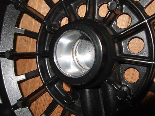

One of the issues that came back with the 907 after it's holiday of 9 months was a dead clutch. The Clutch master was still full of fluid, but no pressure when the lever was pulled. I t bled out OK, and clutch was back, but has been slowly getting softer as time goes by. Pumping the lever daily keeps it all operational, but it is a bit of a pain. So first thoughts are to put a kit through the Master cylinder, replace the Slave cylinder and while going mad, replace the clutch line with a braided line. The Master cylinder kit is on the way, and both links in G's first post are still active. Was going to stump for the US version link, but the pictures show it only has one connection for the bleed valve and line connection. The 907 slave has 2, one for each. After looking through numerous parts lists, later clutch slaves use a dual purpose banjo bolt, that adapts a M6 bleed valve to it. Pretty much a dual purpose fitting.
The question is, do the billet slave cylinders come with this fitting? Has anyone purchased either of the above, and had all the bits and pieces to put it all together without having to run around like a blue a**ed fly trying to find the parts.

Aftermarket clutch cylinders come w/o the fitting. If I knew I would have sent you one with the other bits. I ordered a few once for the master cylinders but now have radial pumps which have a bleeding nipple.

I`d remove the cap from the clutch master cylinder, attach a large syringe to the bleeding nipple of the clutch cover and suck out the brake fluid. Then remove the cover from the bike. Close the bleeding nipple by hand, put the clutch cover on the table with the inner side up and put a towel over it. Hold your hand on the piston while with a compressor you blow air into the cover to pop the piston out. Keeping everything under an old rag or towel will stop the piston to fly through the garage and to spill the remaing brake fluid that`s in the cover all over.
Thoroughly clean the cylinder. I did this beginning of this week. As it didn`t look as good as I thought it should I sanded the cylinder carefully with 1200 and 2000 grit wet and the polished it with Autosol. (used brake cleaner to wash the remaining polish off and out of the channels)
When putting the piston back in apply some brake fluid on the pistons seal and push it back in (as straight as possible and don`t forget to reinstall the spring that`s behind the piston).
Removing a bearing from a (P750) clutch piston is really difficult but you won`t have to do that if you replace the whole thing. Sometimes the mushroom pin will sit tight in the piston, too. (Speaking about them. I wished there was someone who manufactured a couple. I could need one or two wink wink
Pushing a new bearing into a new piston is easy.
The 906 clutch piston is totally different (http://forums.ducatipaso.org/viewtopic.php?f=2&t=7124) but can also be replaced with 19520023B. The 906 piston is easy to identify by its oil seal.
