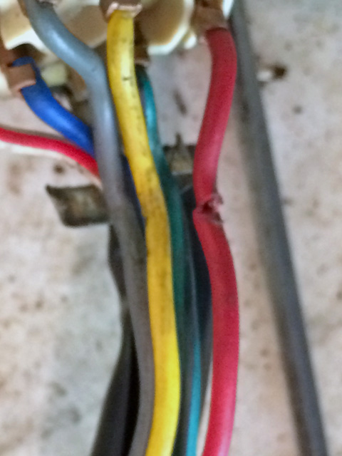

as you mention it angelix I received the following pic from a forum member a few days ago.
This is the strain-relief below the ignition switch. It had almost completely cut through one wire. A hard thing to find as when the strain-relief is closed/pressed together you won`t even see the damage.
