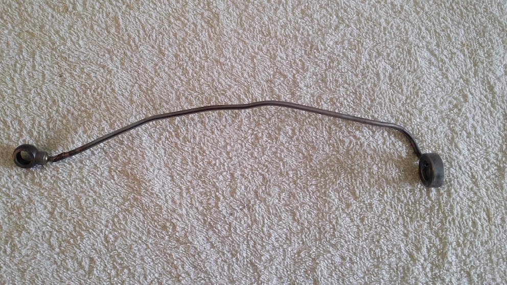

Hi guys here is the picture of the mystery oil feed pipe on my 750paso. hoping it will send cheers dj

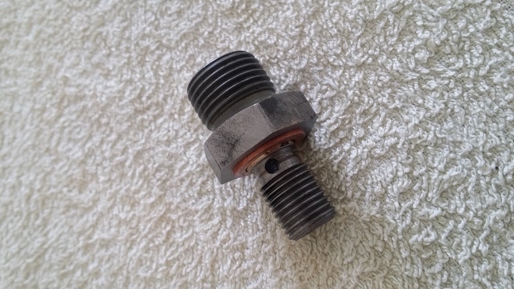

2nd picture this is the union the pipe fits into located at front of the engine joining to the lower union.

- Posts: 5570
Re: paso oil feeder pipe
I`d like to see how that`s installed on the engine. I still don`t get what the oil line was/is for.
However if you need a new adapter to fit the original oil hose to the engine it`s M14x1.5 to 1/2" BSP.

pearlpaso
- Posts: 6
- Joined: Tue Nov 17, 2015 10:23 pm
- Location: New Zealand
Yip the exact piece. looks like im going to need to spend some $ on resurfacing the face on the engine so the inner copper washer seals properly. Unless there is a product such as Automotive sealer which will take up the slack. Back to the drawing board. thanks for the help guys i will keep my progress posted.

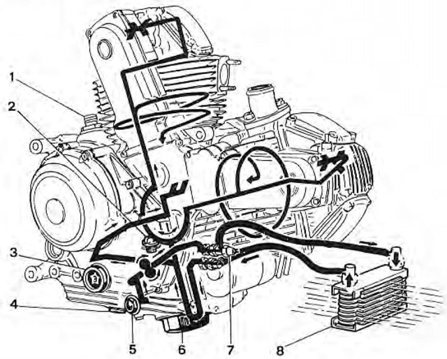

- Posts: 5570
I don`t see the sense in it. The tube connects the return line from the oil coolers to the oil sump (below the oil level). Wouldn`t that reduce the oil pressure a bit that supplies the oil to the heads?
