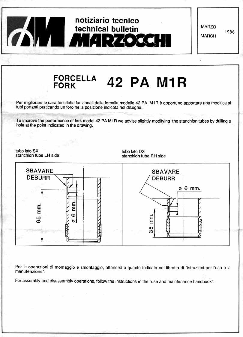

There was a tech bulletin from Marzocchi which was also on the forum for a while but which I removed as it is for a M1R but for the "42 PA M1R" which is an offroad version used i.e. on a 1986 KTM.I have seen a copy of a factory document that suggests drilling the oil passage holes
While that mod may work well on our M1R, too it might not really be necessary as it doesn`t travel that much.

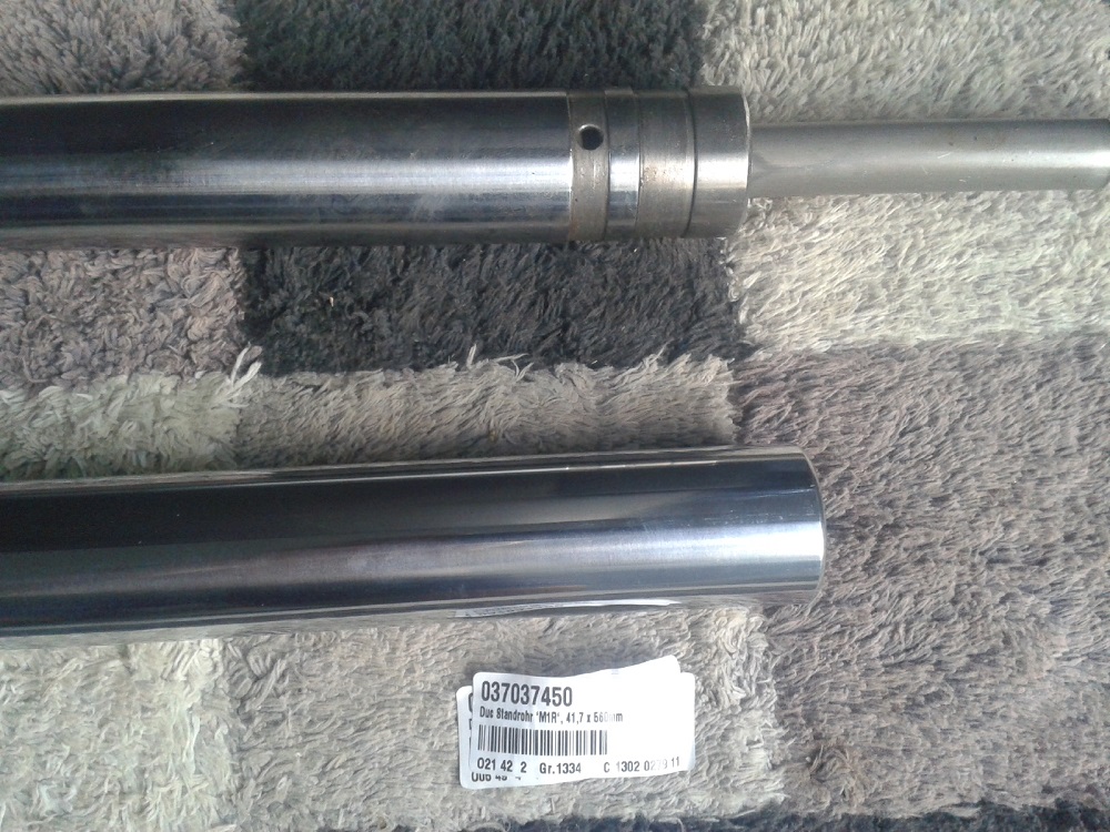

Hopefully I can get these photos downloaded , original fork tube & new tube with part numbers.
looks like one of them worked !
As you can see they are totally different at the bottom end of the tube , anybody seen these before ?

Yeah, that doesn't look right. No place to mount the lower bushing our let the fluid pass through.

I have seen photos on the net of similar plain looking tubes , they where on a Ducati / Paso / M1R forum but I have no idea where !
It was these photos that made me think that there was a variation in the style of the tubes or maybe for a different model rather the reject them & return them to the supplier .
I will have to wait a bit & see if any more info comes to light before I think of what to do with them .
