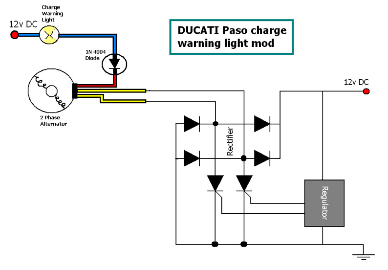

OK, here is how it works and what to do if you have purchased an aftermarket Rectifier with no charge warning light circuit. The two yellow wires enter the Rec/Reg and the AC voltage is converted by a full-wave rectifier. Once rectified this represents the 12v DC system. You can still use a three-phase rectifier; only use two of the power inputs. The Red wire is connected to the alternator winding and does supply an AC voltage but it is a signal wire, not a power wire!
To utilise the charge warning light, connect the blue wire to the red wire using a series '1N 4004' diode, with the blue wire being the positive voltage source. When the engine is stopped, a very low leakage current will flow from the charge warning light, thru the windings and thru the Rec/Reg diodes - it is a very low value but enough to illuminate the warning light. When the motor is started the red wire will emit a voltage. The Red wires AC voltage opposes the 12v DC feed thru the charge warning light and the light goes out! The DC circuit is protected by the 1N4004 diode.

I can see how that will work but it's NOT the arrangement of the original wiring and regulator in which the red wire is not the for the charge light and the regulator has an output terminal dedicated to it.JWilliam wrote:OK, here is how it works and what to do if you have purchased an aftermarket Rectifier with no charge warning light circuit. The two yellow wires enter the Rec/Reg and the AC voltage is converted by a full-wave rectifier. Once rectified this represents the 12v DC system. You can still use a three-phase rectifier; only use two of the power inputs. The Red wire is connected to the alternator winding and does supply an AC voltage but it is a signal wire, not a power wire!

Well it works for me my friend, the battery is charged and I have my warning light back. I know how the original wiring is and that the Energis Rectifier is a do-it-all unit. As for the Red wire not being for the charge light - how do you know its not for the charge light?Derek wrote: I can see how that will work but it's NOT the arrangement of the original wiring and regulator in which the red wire is not the for the charge light and the regulator has an output terminal dedicated to it.
The aftermarket Rec/Reg unit on my Paso has no terminal for a charge warning light, its a 2 phase Alternator - meaning two power wires. No matter where the red wire is placed in the windings, it will produce an AC voltage so what else could it be for? Rectifying the Red wire causes a hot terminal, so using it for a milli-amp bulb is going to stop that. Even if this is all wrong, it solves a lot of problems and doesn't create any others.
Look Derek, we all want you to have a smokin' Paso, just not literally OK?

Well, let's not argue about it, and it is good to see that you have come up with a circuit that maintains the charge light using a regulator that has no provision for one.
And incidentally a 2 wire alternator is single phase.

One look at two and three phase Alternator diagrams will produce many variants. Three wire 3 phase alternators are available, for instance. This Ducati Alternator is a 2 phase with centre-tap and yes, it appears the tap can be connected to 12v as this next link shows (wiring diagram from a 750GT at bottom of page). Not sure if I'd want to do it what with melting plastic on a terminal when I have sent it thru the rectifier (same thing). So all told its difficult to know if I'm doing entirely the right thing. However, with only the pink wires to the rectifier, it is charging...
http://willyg.homelinux.net/Alternator/
Having a read of this article it would seem that if the two pinks are rectified and the red goes to 12v then high load charging (ie all lights on) is good but low rpm charging poor. If only the two pink leads are sent to the rectifier and the red wire centre tap disconnected (or used for a charge warning circuit) then low rpm charging is better but high load charging is worse. But no harm done.
Re: Horn kills the motor?
the center tab is an exit for the positive halfwave. Being positive it doesn`t have to be rectified just voltage regulated as is shown in Dereks picture. The alternator will work also if the center tab isn`t connected or used for something "different" but that will impact the efficiency (curve) of the alternator meaning it won`t reach its full power output potential. At least this is my understanding.
What seems wrong to me is that in Dereks design the center tab connects to negative. That can`t be right.

By connecting the 0 volt line to the centre tap gives effectively a 2 phase alternator. So either end of the "coil" will be 180 Deg apart. So when one end is peaking positive, the other end will be peaking negative. This can then be rectified with only 2 diodes to get what is a full wave rectifier, rather than 4 diodes without the centre tap.
It's all about forward biasing diodes and sine waves.

Yes, the centre tap is to the -ve but the other two are to the +ve and the SCRs are reversed so it will still work.paso750 wrote: What seems wrong to me is that in Dereks design the center tab connects to negative. That can`t be right.
