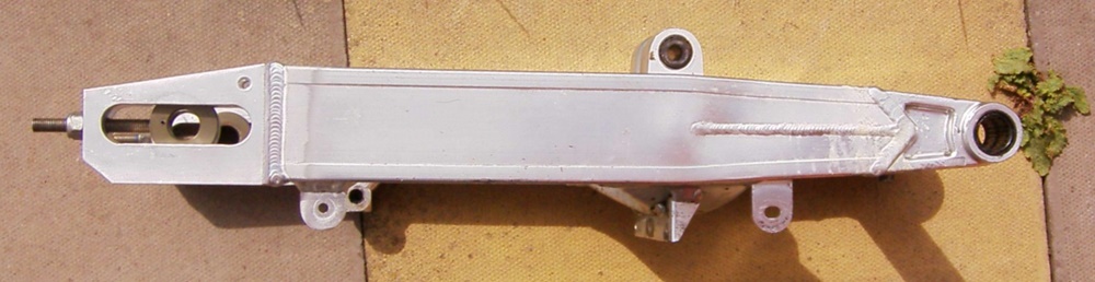

The rear is the thorny problem, and required most thought and effort. A second hand swinging arm was purchased, and taken to Spondon Engineering, in Derby to be modified. The swinging arm is cut just at the point wher the welded on eccentric chain adjusters stop it tapering outwards, and from where the faces become parallel. My calculations had indicated that a 150/80 or 160/80 tyre would need around 1-1.1/4” of extra room, so it would need around 3” of extension in order to accommodate a larger tyre and leave room for chain adjustment, but I asked them for a bit more to be safe. What I got was a 6” chain adjuster extension, using one of their “drag bike” drawbolt style adjusters. That gave me more than enough room to manoeuvre!
The standard wheel, brakes, sprocket etc are all retained, with Spondon providing a replacement spindle, drawbolts and other minor requirements. Because the wheel sits about an inch further back, the standard caliper carrier does not engage with the lug welded on to the top of the swinging arm to prevent it rotating. Accordingly, I had to make up a stop to fit, which I did using a section of 1” square alloy, with a suitable size bolt to replace the lug. This was then attached to the existing boss atop the swinging arm using a section of 90 degree angled alloy. The only drawback to this is that the standard silencer fouled the bolt, so judicious application of a 2lb lump hammer to the back of the silencer created a recess which is unnoticeable from anywhere except within the rear wheel.
The centrestand was modified to include an extra inch of length, so that the rear wheel stood clear of the ground when parked, but I didn’t change the sidestand. It just leans a bit further. Also, as the rear mudguard would have fouled the bigger tyre, I created a little extra room by cutting the mudguard (which is only plastic) from the direction of the wheel centre out towards the angle at the top of the number plate. The whole rear section can then be bent out slightly, and I used a couple of small alloy plates pop riveted to the mudguard sides to keep the position. This was then covered over with a small section of rubber glued to the outside of the mudguard to hide the spacer (in fact I used a piece of old inner tube – the right colour, flexible and waterproof).
Finally, to get rolling again, a new piece of brake pipe was required, as my old braided line wouldn’t stretch the extra inch, and a new chain with five extra links took up the required length in the drive train.

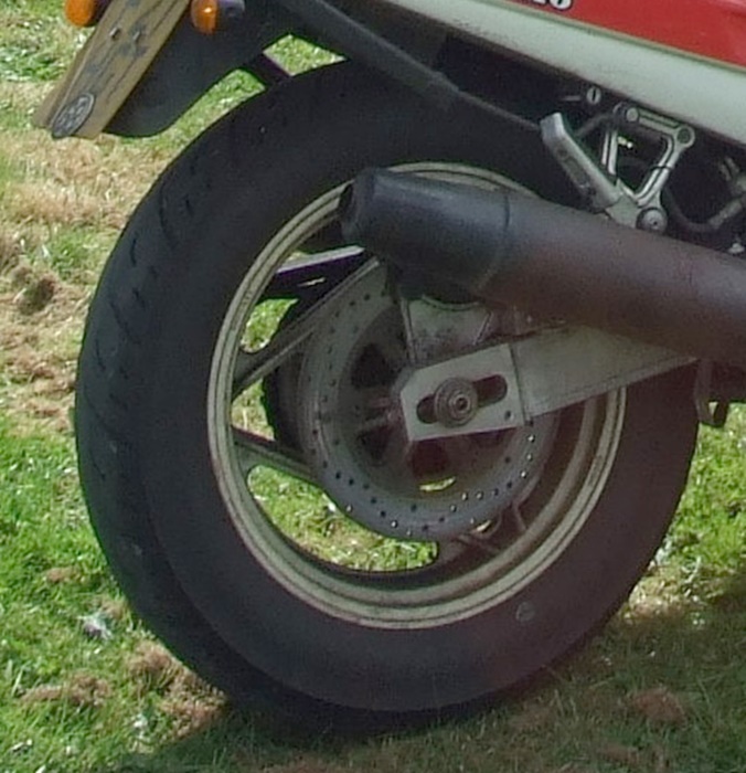

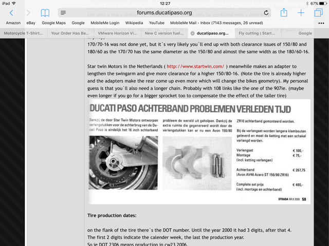

Hi spaggy. This is an excellent post- thanks for sharing. I spotted another rear wheel solution elsewhere see photo. What are your thoughts? I'm a but concerned at how much higher the rear of the bike could be with some chain tension positions. ( does a 16 wheeled bike need even sharper steering!!!!.
Having said all that I'm super interested in the option as I could knock up the spacers on my mill and lathe!

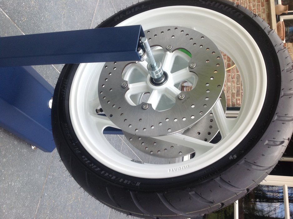

- Front wheel
- image.jpg (163.36 KiB) Viewed 13078 times

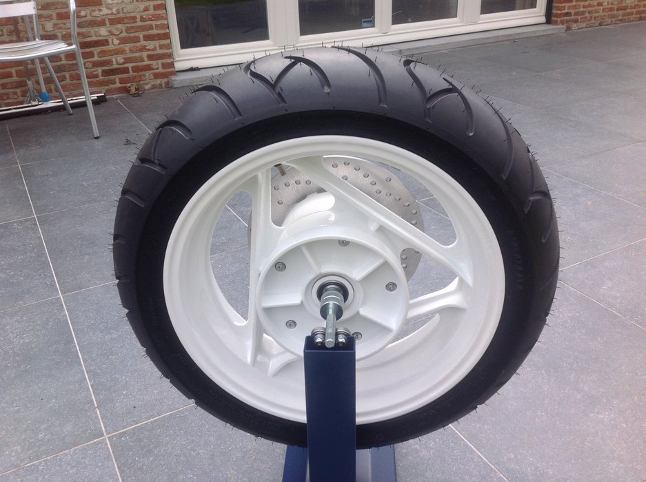

- Rear wheel 2
- image.jpeg (126.36 KiB) Viewed 13078 times

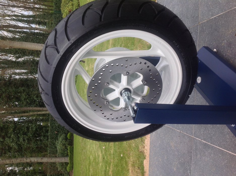

- Rear wheel
- image.jpeg (156.19 KiB) Viewed 13078 times
Re: Fixing the 16" tyre problem
Good point I'm always looking for the complex interesting answer when there's a simple one on offer.
I guess another sale for golden tyres 16 inch will encourage them to keep making them,
K

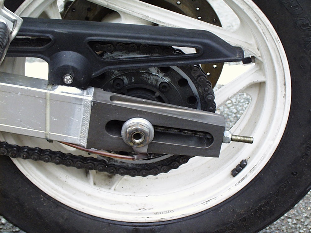

The weakness of the 750/906 Paso swingarm is that the lower eccentric 'U' bolt hole goes thru a weld and this thread can fail. Not clever. Having a sliding adjuster conversion is a good idea since the swingarm is of a sustantial thickness, and £200 isn't much to spend on it.Kmamac wrote:Hi spaggy. This is an excellent post- thanks for sharing. I spotted another rear wheel solution elsewhere see photo. What are your thoughts? I'm a but concerned at how much higher the rear of the bike could be with some chain tension positions....
