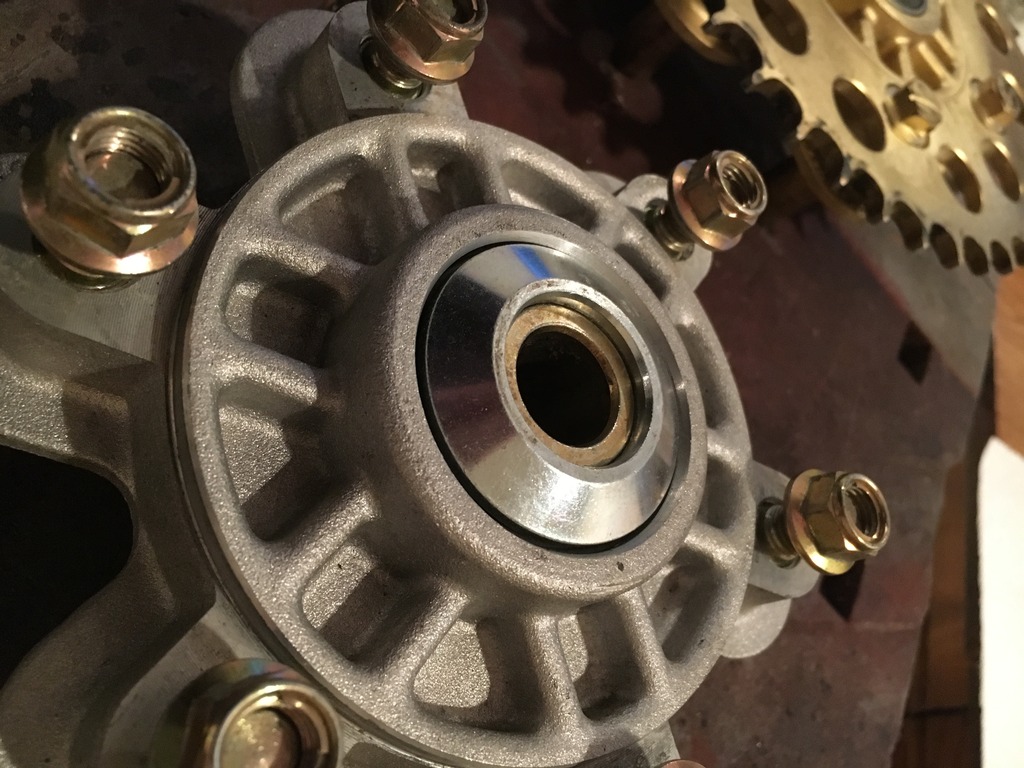

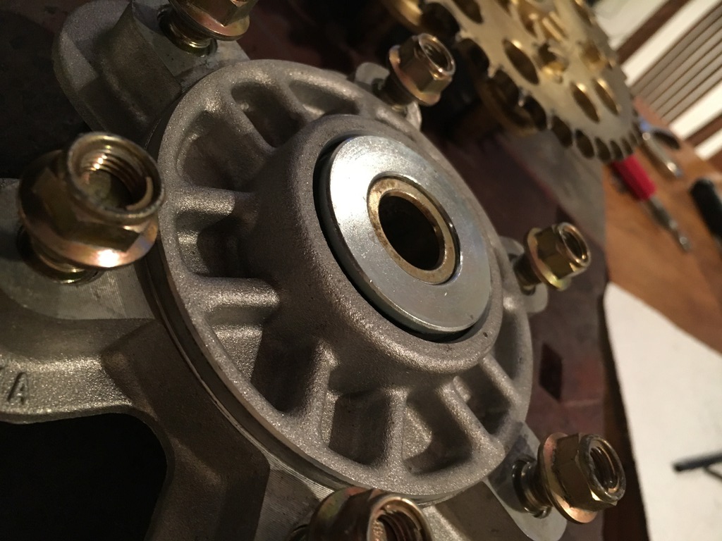

Re: Rear wheel bearing question....
I agree Gerhard....new parts, tried wrong way around, the spacer sits directly on the steel retainer ring (first picture), I can imagine after tightening the axle and riding, it would shortly destroy the hub.....just for the record...this is the WRONG way..easy enough to get wrong..
Just as your graphics show G.
Tnx
Tnx
I corrected them a bit.
You got the parts quickly
Thanks for the pictures!
