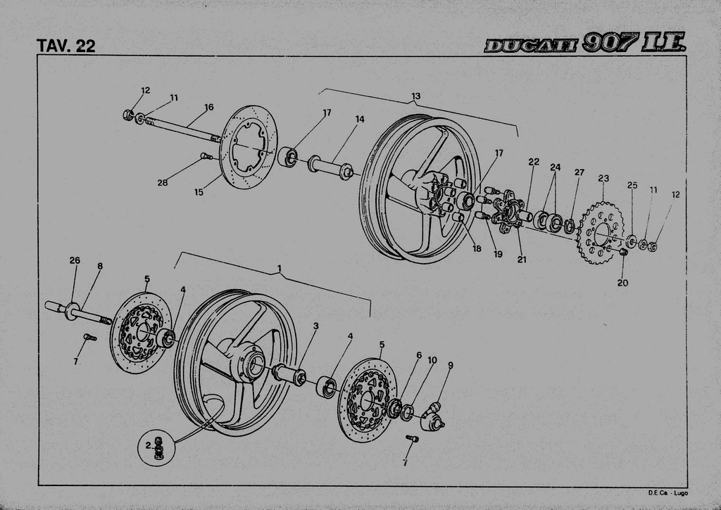

A while back , I removed the rear wheel, new tire, cleaned up everything, checked bearings etc...put it back together, no issues.....until....I was perusing the parts book and noticed the spacer assembly is not the same....in the image, spacer 22 has a groove for circlip 27. My part 22 does not have a groove, no circlip and it was installed backwards, otherwise there is nothing to hold the bearing in.....my question is, can the cush drive be installed backwards?...is the parts image wrong?....I put it together the way it came apart, didnt notice anything strange, no excessive play or binding.....

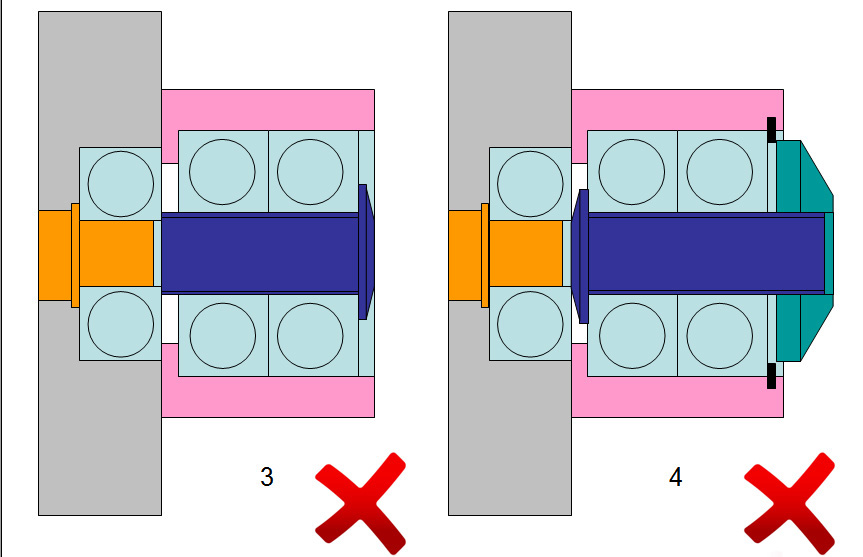

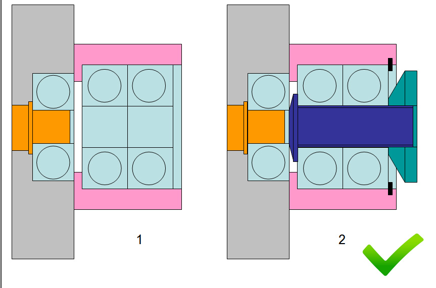

I don`t own a bike with 17" wheels but the answer seems quite logic to me. As its hard to explain I made some quick drawings in Powerpoint.in the image, spacer 22 has a groove for circlip 27 ... is the parts image wrong?....
But first to your questions. The groove for the circlip is not in the spacer but in the sprocket carrier and the image should be correct.
As an explanation to the drawings. They are of course very simplified
1. is w/o the spacer so there`s nothing between the wheel and sprocket carrier bearings
2. is as the parts catalogue shows it. Spacer 25 goes against the inner race of the bearing. The circlip (black) holds the bearings in place.
3. is how you installed it. That would hold the bearings in place but there`s no support between the inner race of the wheel and sprocket carrier bearing
4. is if the conical spacer is installed the wrong way around. Eventually it will touch inner and outer race of the bearing and lock it. The spacer will start to spin with the wheel and eat itself into the swingarm.
As the pressure of the torqued axle should only be on the inner bearing races drawing 2 is the only one that makes sense.
- Unbenannt-1.jpg (90.31 KiB) Viewed 16599 times
- Unbenannt-2.jpg (101.58 KiB) Viewed 16599 times

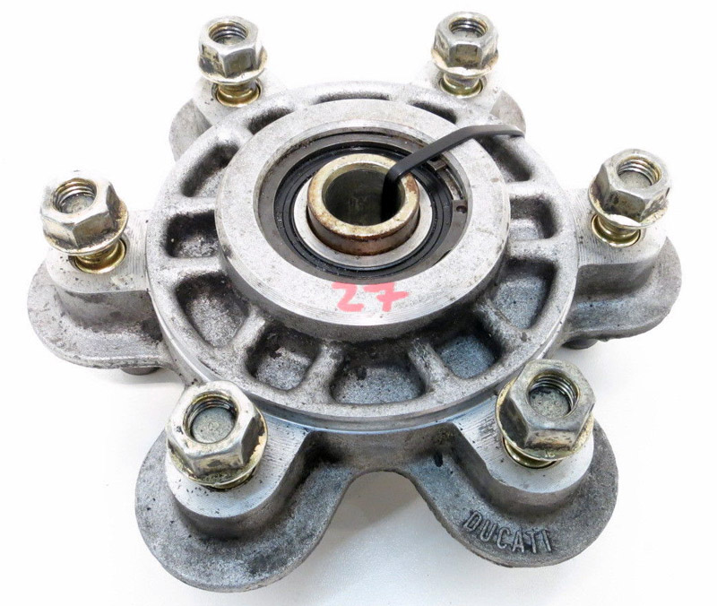

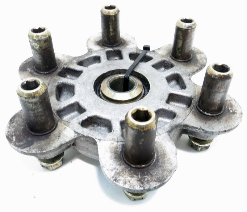

Re: Rear wheel bearing question....
this is from a Monster. It shows the circlip and corresponds to drawing 2
- $_57c.jpg (171.61 KiB) Viewed 16719 times
- $_57d.jpg (131.63 KiB) Viewed 16719 times

I had mine off to fit a new tyre last week. As said above, the circlip holds the bearing in place.

O.k I see now....I am missing the circlip and the outside spacer #25....... thanks, G. Next ? is, does someone have a spacer to sell....?? Or dimensions.... Circlip I can come up with.....

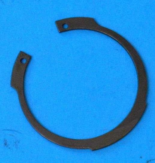

If you look at the Stein Dinse online parts catalogue you find that that spacer is #71310321A and was superseded by #71310321B.
If you click on the "order" link you get to another site that shows a picture of it and a list of all Ducatis that use the same part. In this case:

You can buy a used one for $20 on ebay or visit or call your local Ducati dealership and have them order a new one for $13.58. The circlip (#88440011A) which is used on the same bikes costs $2.10. (on ebay at least $10 incl. shipping

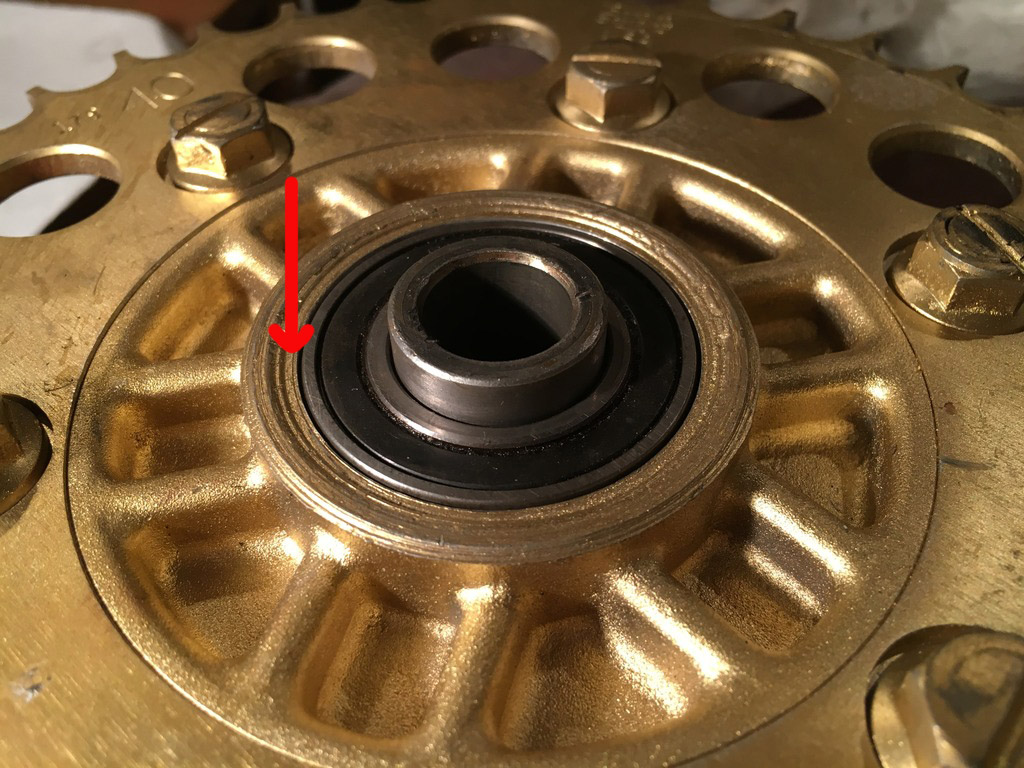

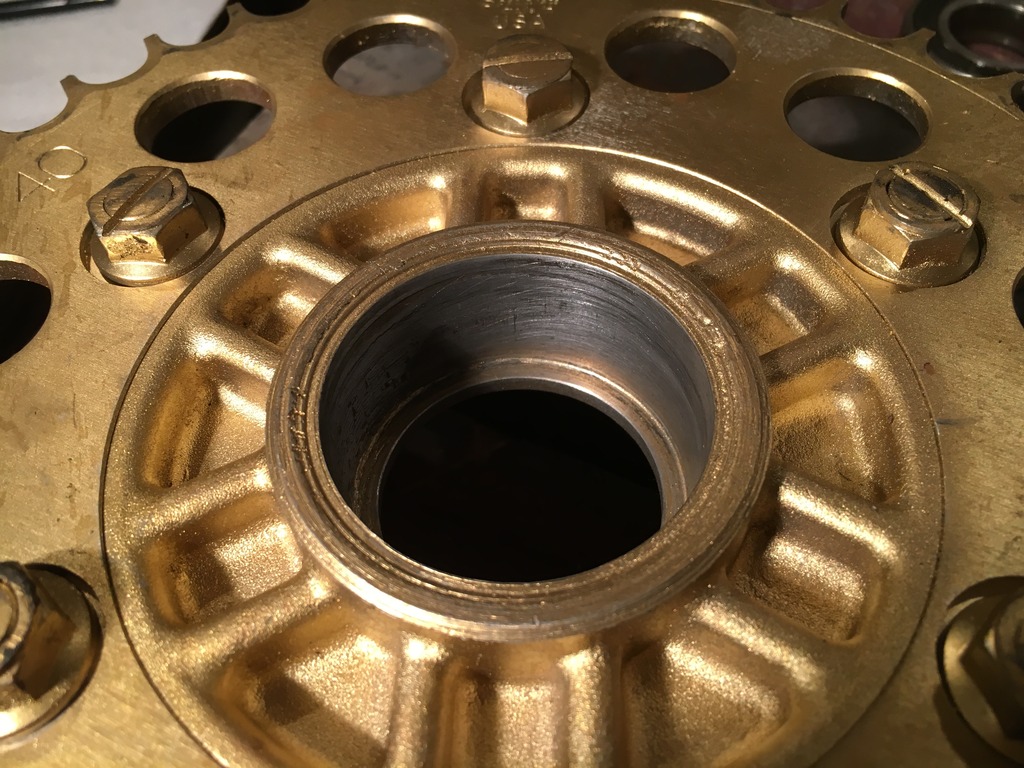

Honestly, nothing is easy in my life these days.......here's what I have, explains why I didnt realise I needed a circlip.......
Bearings are 47mm, 25mm, 12 mm, which I'm guessing are wrong, I would think 10mm would give room for a clip.....so was it machined out for some reason? I suppose I should find a housing and do it right......what say you?..

Now, looking at the picture Gerhardt posted, I think it was machined down to the original groove...I wonder why....

- Posts: 5570
You are too quick on ordering parts. Another look at the Stein Dinse online parts catalogue would have shown that the bearings are 6005-2RS1 which are indeed 47x25x12mm.
Did the bearings sit correctly and which depth does the sprocket carrier measure?

Comparing your sprocket carrier and the picture I posted I notice something.
Your spacer sticks out more and the center of the sprocket carrier is not that high. The top area has a marked surface and isn`t flat. There`s one area that could have been the circlip grovve. So for whatever reason some material may have been shaved off the sprocket carrier.

I agree although I dont understand why that would be done...
Gerhard, I didnt see any other option than to replace the carrier....

Now after seeing that it does make sense.
- Posts: 5570
maybe that damage is a result of installing the conical swingarm spacer (25) the wrong way around with its wider side towards the sprocket carrier instead of towards the swingarm.
