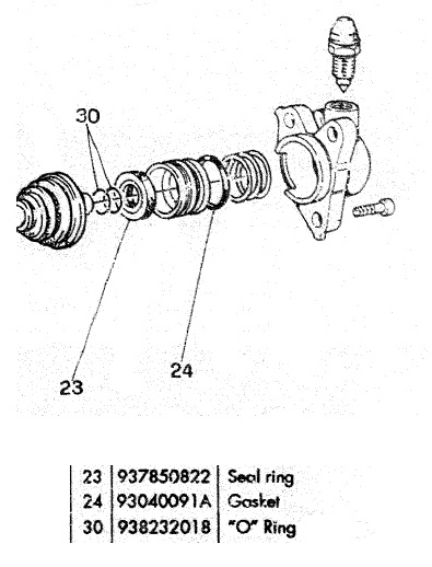

Re: Clutch Leak??
Stiv, which of the three are you referring to?
- Unbenannt-2.jpg (106.39 KiB) Viewed 74288 times

The kit I purchased was a full set replacement in one bag. It is a full service kit sold by Ducati. It is the same one used with several models apparently? Either way it fixed my problem which was an internal leak on the shaft input seal.

I took the slave cylinder off, and the big accordion like seal has a kink in it. It is the seal that Paso750 posted in the picture above to the far left. I don't remember seeing this seal in the picture of the rebuild kit # 1959023B. Does anyone know if this seal comes in the kit, or do I need to order this one separately? Have a good weekend!
Warm regards, Paul
Warm regards, Paul

Sorry guys, i found the part # for this seal, it is the clutch rod plug # 67210061A. Is it possible that the leak could be from this seal being kinked?

Sorry for my ignorance, but I only see two small seals on the clutch rod. Are these the seals I need to replace? The fluid was coming from the outside of the slave cylinder. I can't figure out how to take the slave cylinder apart. The seals on the clutch rod look smaller than the diameter of the rod. Thank you for your patience and help!
