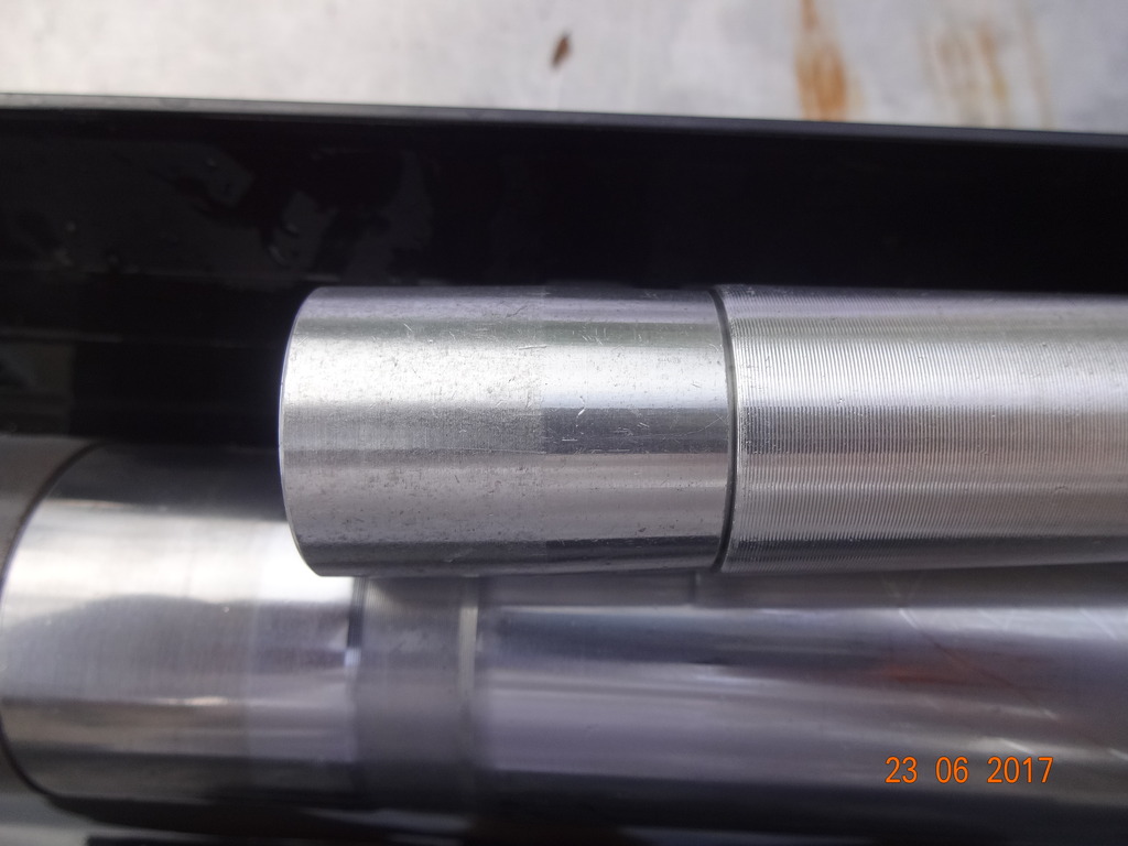

Have stripped forks and found it all in good order...very straight forward, used a hot air gun to help removal of old seals but... can anyone confirm the small aluminium sleeve end (LHS) is fitted correctly with taper facing towards the main shaft (the one with short spring)...it dropped off as my 9 year old daughter came down from her bedroom to tell me she couldn't sleep and needed a drink!!!
ps I used a section of plastic rain guttering to help disassemble fork tubes and keep parts in order and be able to degrease them...
When I come to filling the tubes with oil, do I push down the chrome tube into the lower housing then measure the oil height???.
yes (if with oil height you actually mean the air gap from the oil to the top of the tube)
