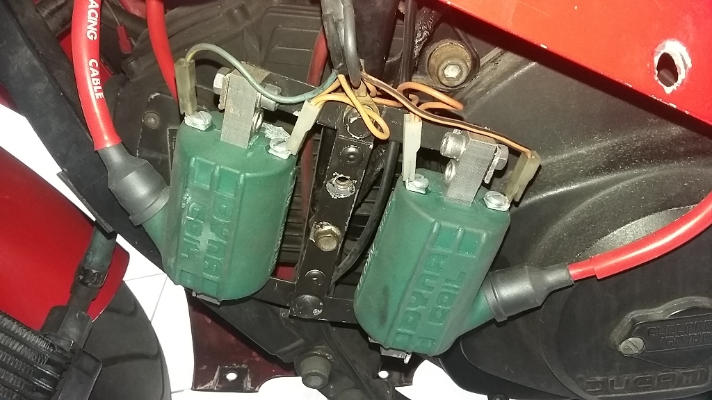

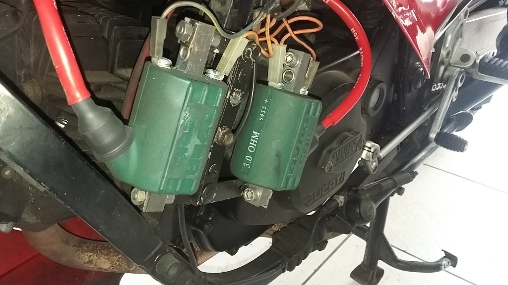

Hello everyone! I replaced the coils were 30 years old I replaced with Dynatec ...

That they worked and it is running is great news, but good grief, clean up the wiring!
And, how did the left side panel upper nut hole get ripped open?! Possibly a large drill was used to install body work bolts?

Re: Announcements
David that is how the original wiring looks like.
aldo.agus what you should do is measure the voltage. Since the wiring is original you may still have the typical voltage loss which means that the coils will not work with their full potential. Also check the FAQs or the download topic for the wiring mod.
Re: Announcements
Ciao!Scusate se vi rispondo in Italiano...come ho scritto ho dovuto sostituire le vecchie coils e relativi cavi sparks,perché ormai guasti,ho controllato i cavi ingresso (arancio/nero -azzurro chiaro-arancio) e sono in buone condizioni.
Il miglioramento è per me molto evidente,non più buchi o mancamenti versoi 3500/4000 giri/minuto,ma molta più fluidità.Vedrò per curiosità e scrupolo di effettuare il controllo e farvi sapere!
