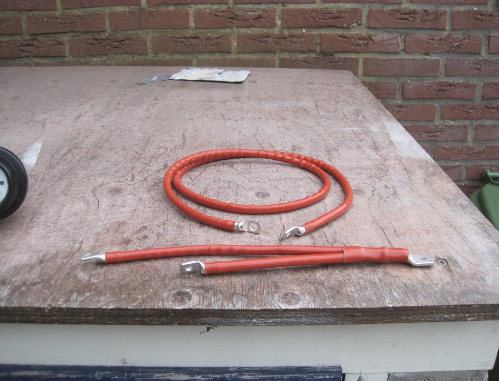

Cables 16 mm2 (5 awg)

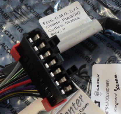

The spring connector looks the same as the ones used on my '86 Vespa T5 instrument panel. So you can check, the overall width of the connectors is about 6,8mm, the width of the contacts 2,6mm and the overall length 21mm. There's a logo on mine but I can't identify it.
Piaggio's supplier of their wiring O.M.G S.r.l..

O.M.G. seems to be a dead end. However those connectors were commonly used on Veglia instruments i.e. on Fiats and Ferraris. Veglia (Borletti) was taken over by Magnetti Marelli.
In an italian Fiat Panda 4x4 forum I found a link to this catalog. Check p.23.
https://app.box.com/s/rtdmucey4aumngggsjqxc8a8vn7x32u5
The company is COPAT in Italy. http://copatconnectors.com/
The bad news is the link is to their 2013 catalog. In their 2018 catalog the connectors are not listed.
If there's an old BOSCH service in your area it might be worth checking if they have something in their old stock.
Btw the circuit board/foil is from SILGA.
